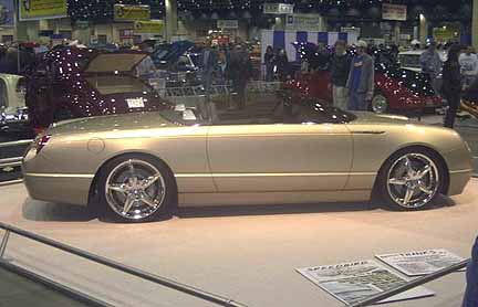

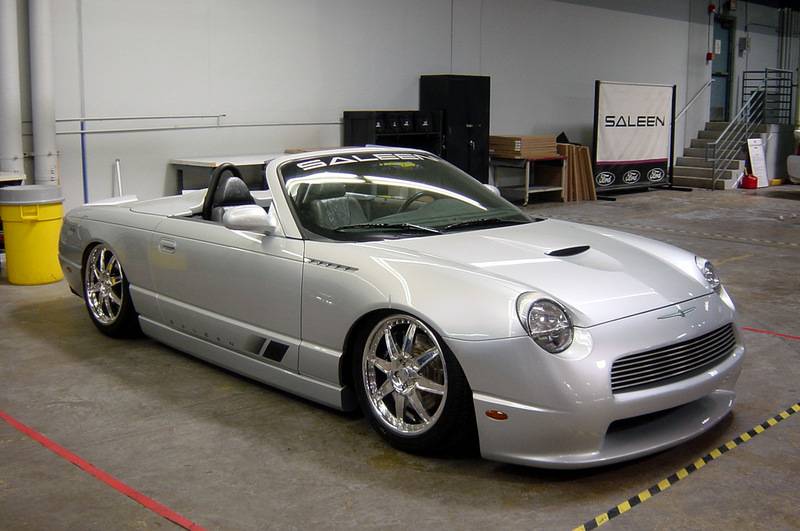

The Saleen T-Bird concept shouldve gone into production. Its pretty nice IMO. It could have helped save the car form being discontinued...
That saleen t-bird ir pretty sick!
The Saleen-bonspeed Edition Thunderbird sports a 3.9-liter V-8 with Saleen Series IV twin-screw supercharger, cast aluminum manifold, and water-to-air intercooler, and promises around 365 horsepower and 390 lb ft of torque. The production version will feature a Saleen PowerFlash engine management system, and can be mated to either a five-speed automatic gearbox or an optional Saleen six-speed manual version.

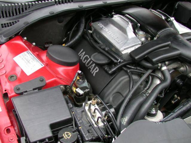

The 4.2 electronics are different. Whoever did that supercharger swap put a ton of work into it.
I know they are but the t-bird and ls should be the same. So it can be done as we just saw with the picture.
The pictures don't show if the instruments and climate control still functioned correctly. However, I suggest you prove us wrong, do the upgrade, and show us how.
