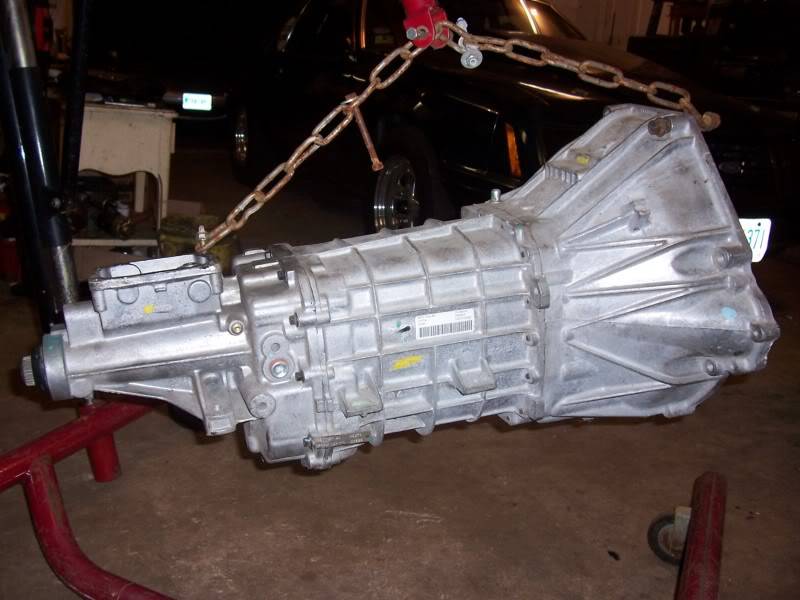

Let's look at it from the perspective of manual conversion kit.
There might be a couple of options here which would be the easiest to produce (this is probably not the right way to do things according to many in this forum).

Ford V8 t5 can handle 300 lb-ft (Not looking for disputes here I know there are different variants)
An updated version of the t5 out of the 2005 4.0 Mustang can be made to handle 330 lb-ft by using 2.95:1 gear set.

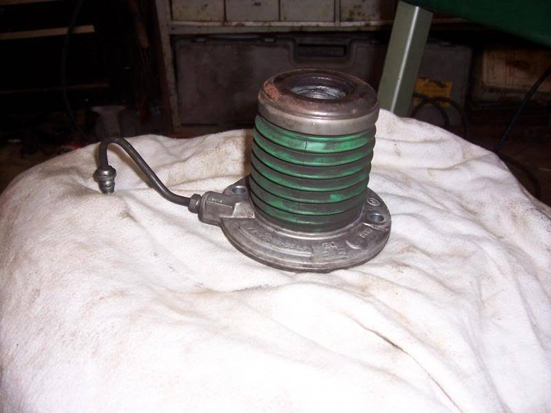

One other ? are the V6 manual LS's hyd or cable clutch? If they are hyd then you just run the stock Ford hyd throwout bearing after you get the stock hyd pedal stuff out of V6. This is the one off the 3650.
Also this trans out of a stang one year newer is the "short" style where the shifter bolts on to back of trans tubular and you can really easy move the shifter front to back.
The stock LS V6 was a hydraulic clutch. Unfortunately, because these cars are relatively rare it is virtually impossible to find the parts.
The Slave Cylinder picture that you attached is exactly the same for all 2005 -2008 V8 and V6 cars. These clutches are hard to bleed but they work well.
