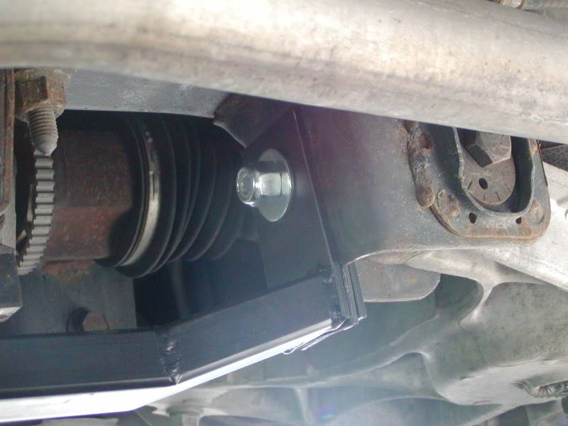

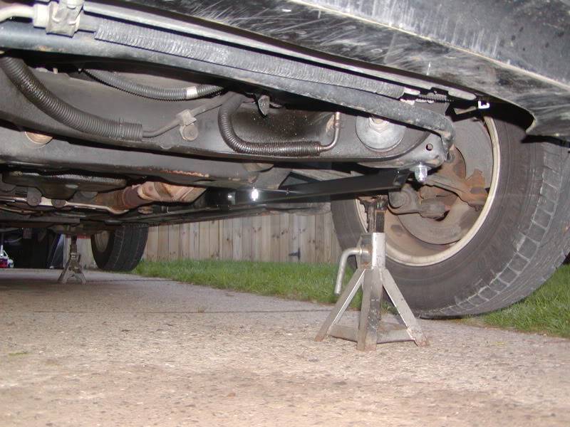

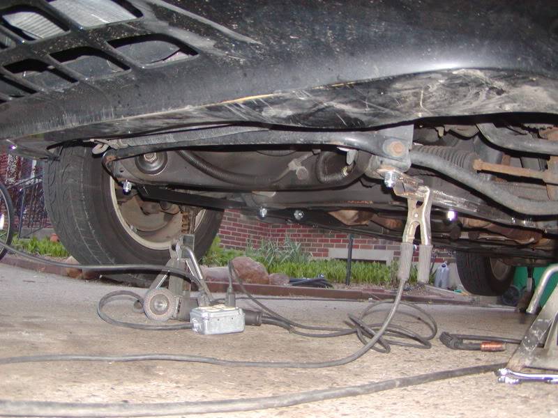

Front braces installed:
(NOTE: This is the first set I made for myself, all current braces have closed ends as shown in the original post.)

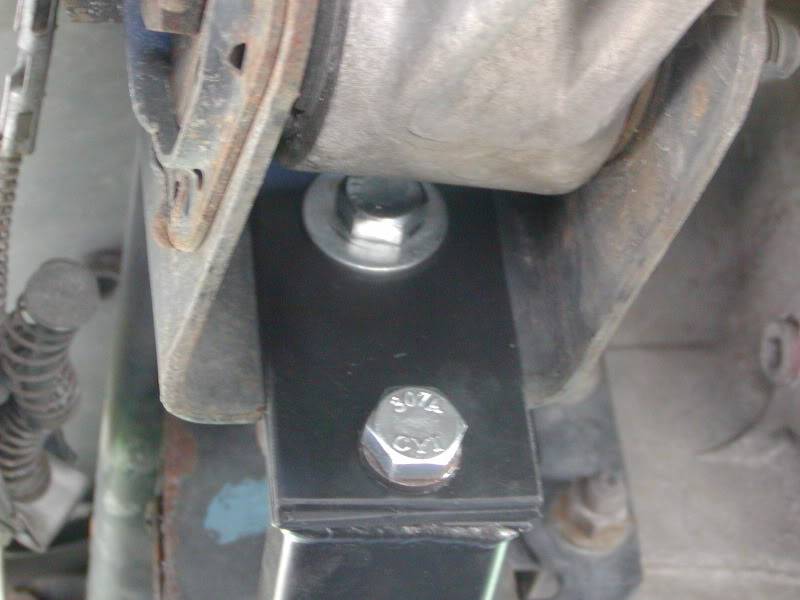

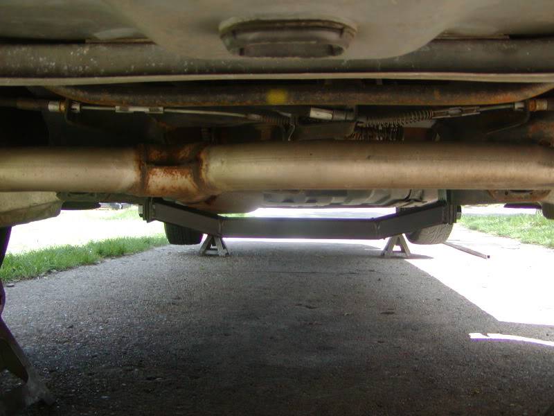

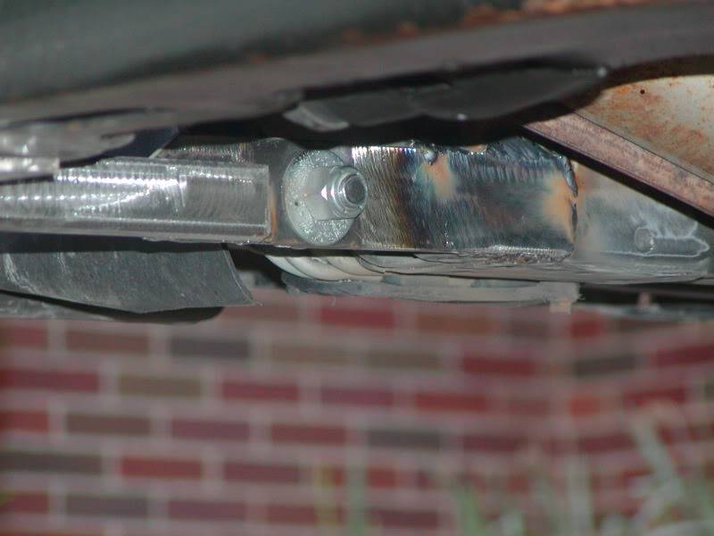

IRS brace installed:
I've heard it scrape twice... With 5 people in the car, over a speed bump... It's never scraped with just me.
It's as high as I can make it and still clear the exhaust.

so the rear IRS brace is bolt in? No cutting or drilling? and the front requires welding?
Correct. Rear is bolt and go.
Front does require welding and one hole on each side drilled to 1/2".
