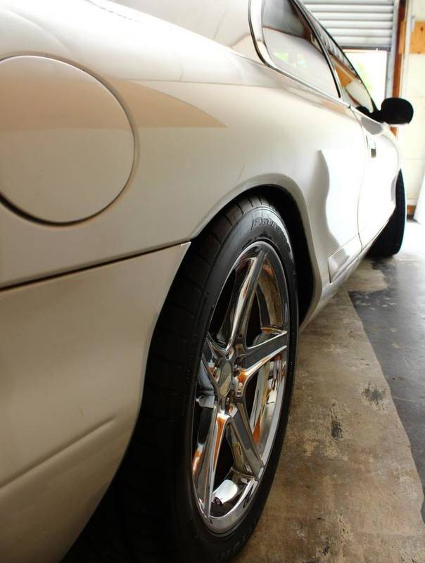

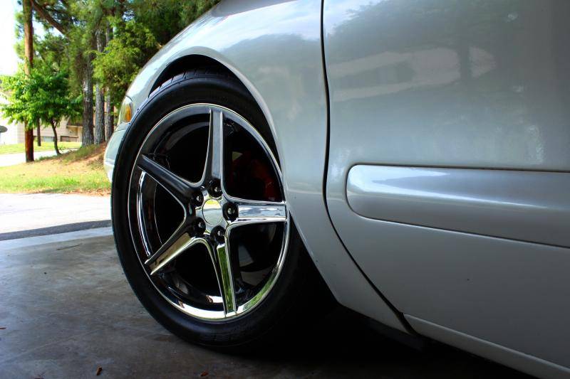

Octane has been on front coil/rear airbag setup ever since I got her back on the road with some minor growing pains at first but have had no problems once all necessary parts were installed. Gleen through my build chronicle to see some of the work done.
I really like the firm ride quality and the stance. Rear airspring's ride height are fully adjustable for varying loads.
looks good! i am ordering my front coils tomorrow from strutmasters! then next week when they come i need to get upper A arms. Is an alignment necessary?
