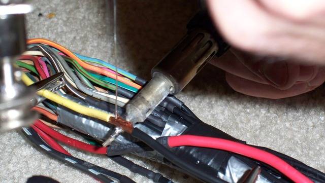

Anyway, I had a thought about the computer issue. Since I have a gen2, I already have OBD2, and the intake setup similar to the 96-98 cobras. I was thinking maybe if I get a 96-98 cobra harness and ecm, I could use that, not have to make an extension plug to relocate the computer, and I wouldn't even need a tune to turn off the auto trans functions, since the cobras came with a 5-speed from the factory. The only thing I'm worried about, is the air ride controlled by the ECM, or is that a separate computer? I'm not interested in losing the air ride, so if its in the ECM, it looks like I'll have to just build an extension and get a tune.

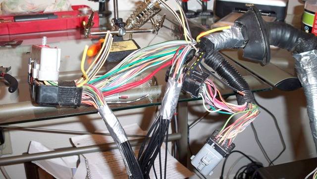

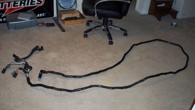

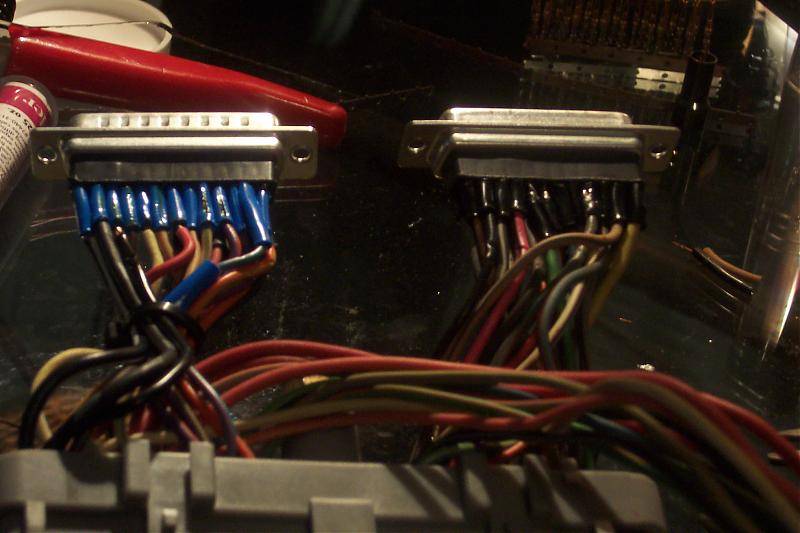

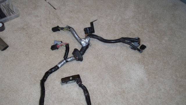

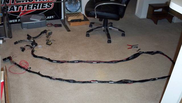

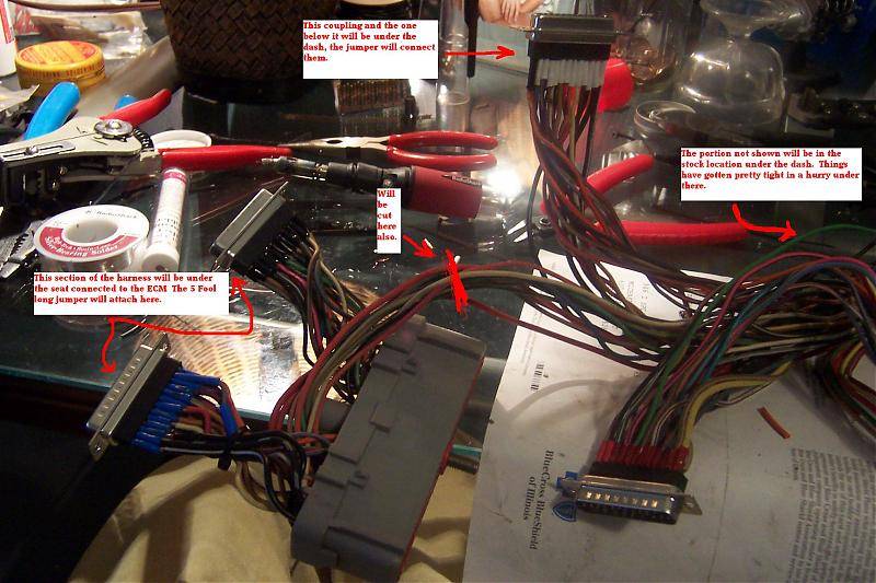

Here are some pics of my new setup for the Wiring harness.
The Last 2 are my old lame brain setup......:) Don't do that.
Mike
Well after looking into it, here is what I'm thinking at this point. Swapping in a complete cobra harness would be expensive, and probably more work than extending it. I'll just make a plug-and-play extension harness so I won't have to cut open and splice every wire going to the computer. I looked over the pinouts on the 96-98 cobra ECM, and there are only about 5 changes that would need to be made to run the cobra ECM with the mark harness and the 5-speed, and that way I should be able to avoid having to get a tune, which will keep the cost of the swap down. Also the changes that need to be made in the wiring would be very easy to do within the extension harness, so the only modification to the mark harness would be to tap into the tach signal wire and run that to the cobra ECM, cause it has that signal going to it and the mark doesn't. Other than that, there are only 3 wires that need to be moved to a different pin and one additional ground wire needed, and then I would need to split out the coil pack drivers because the 96-98 cobra had coil packs instead of COP. All that leaves up in the air is where to mount the computer. Is there room under the passenger side of the dash? I would rather not have to pull out the whole interior to run the harness all the way back to the trunk.

That part is easy. Grab any EEC-V computer, and the pigtail for it. Open up the computer and break the connector off the circuit board, then solder all the wires onto each of the pins coming out where they were going down to the circuit board. Then heat shrink around the joints, and coat the whole thing with a hot-glue gun. This way the joints are all very well insulated from each other, and never move, so it will be less likely to have any problems. Also, it will probably cost a bit more, but I can't imagine doing the entire harness in black wire like you did. I'll have to get the right color wires, or at least close to the right colors.
