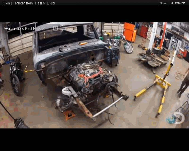

I wish Gas Monkey would do this swap on their show one of these days or anything with a Mark Viii. Glad he chose a black on black to do the swap.
Gas Monkey did do a swap using a Mark VIII engine in one episode.
