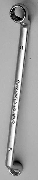

It's one where the neck next to the end of the wrench looks like it's been bent. It's for getting into places where a normal wrench won't fit or has no room to turn the nut and a ratchet won't work because of the necessity to hold the bolt stationary with the hex wrench. Another tool that might work is a crow's foot wrench, which is basicaly the end of a wrench you can turn with a ratchet extension.
