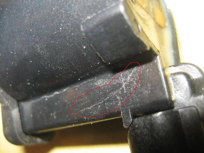

Ok, it was a crack in one of the coil packs. I replaced the coils with a "known good" used set and the problem still remained. After getting my AutoTap and then getting the Enhanced Ford parameters today, I was able to dig deeper into the misfires. It gave me a LOW_WORD Misfire #7, so I pulled the coil and looked at it, sure enough....
I then put the coilpack in a diff cylinder just to make sure, and it followed. Put a new coil in and VOILA, purrs like a kitten. Still got some good maintenance out of it
