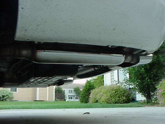

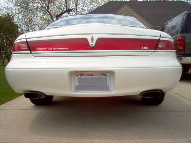

Nice vid. What do you have for exhaust, sounds mean! I like it...
4" MagnaPacks. Way too much drone for me. I like Geno's setup better but I didn't want to cut up the perfectly good and almost new condition stainless exhaust from the factory. To really get a killer sound, you need 2-1/2"pipes all the back. I wanted to keep the stock exhaust tips and keep the mufflers hidden and these worked out great. I have a stainles 2 in/out Magnaflow I might put n next so see what that does for the drone. After that, time to call Geno.
