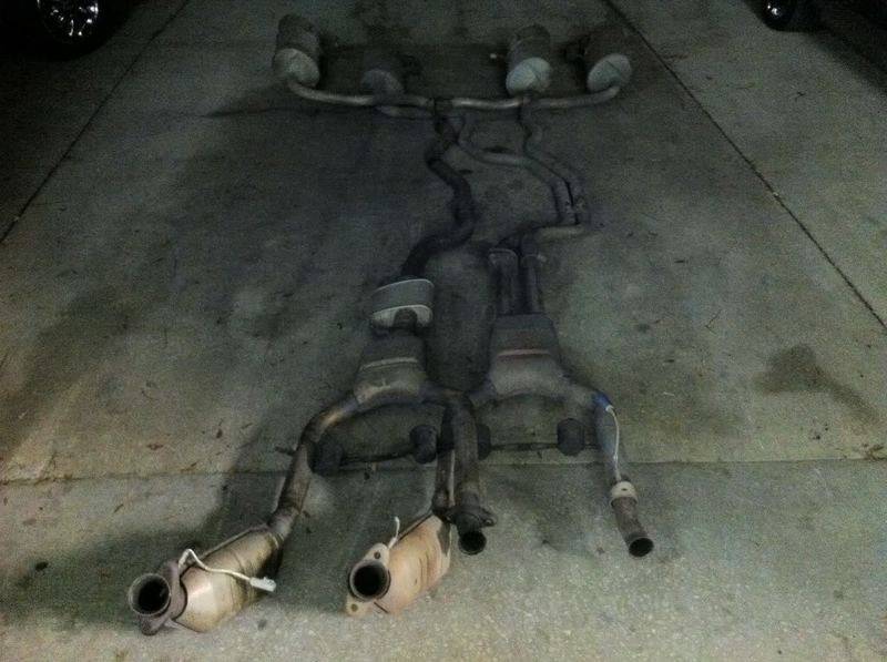

Correct... What sets an LSC apart is the exhaust...and the trim delete package, and some extra letters on the tail light

Side by side of a Base/LSC exhaust...
