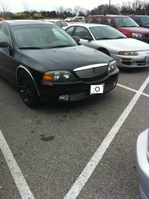

And speaking of fender well chrome.... I saw this car again at Walmart today. More than likely an employee. Hopefully I'll be able to track him down and get him on LVC to convince him to do some chrome deleting.
The front isnt as bad as it could have been i guess? The grille is visibly (up close) attached with zip ties. Maybe if it was black it might be better....

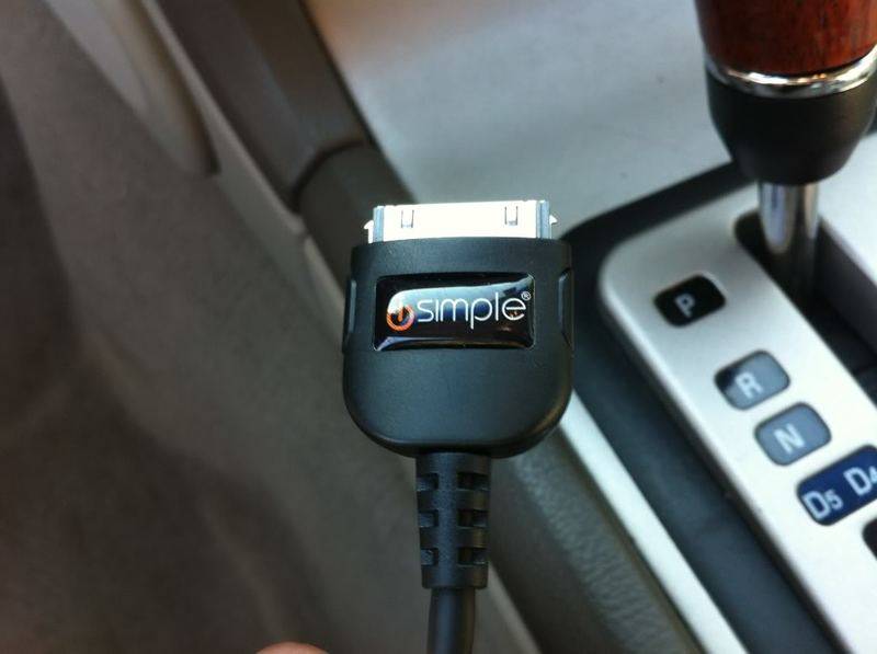

For starters... I wanted to have iPod capability and still keep the stock look of the headunit, so i bought the iSimple TranzIt. It's a really quick install and it just plugs into the antenna cable.

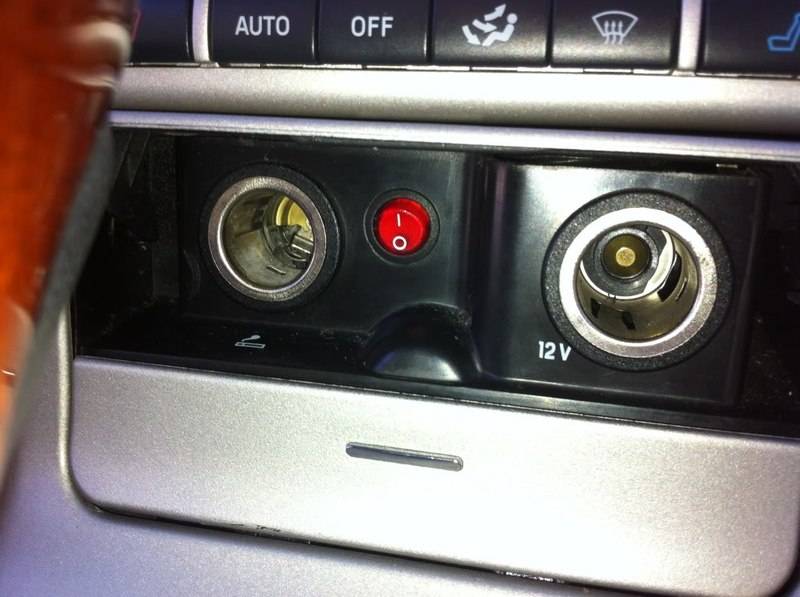

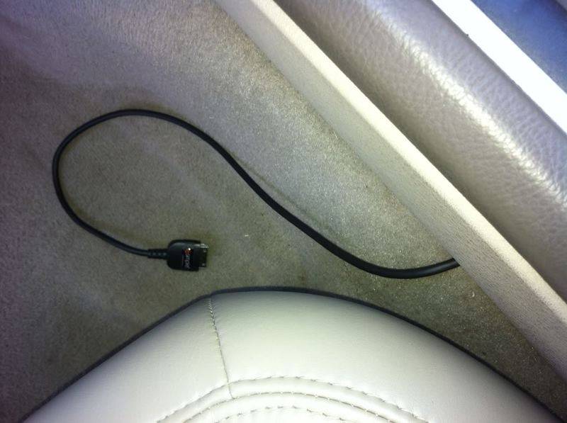

I took power off of the lighter and flush mounted the on/off switch. Ran iPod cable under everything and out by the seat.

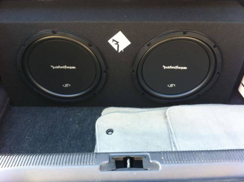

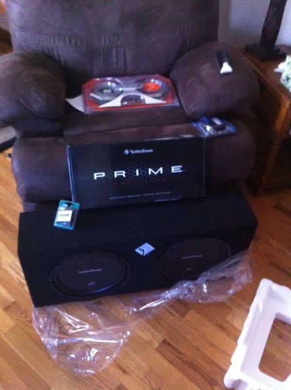

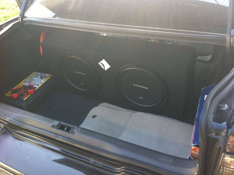

The rest of the pics are the what turned out to be 2 hour process of a sub install Cheers!

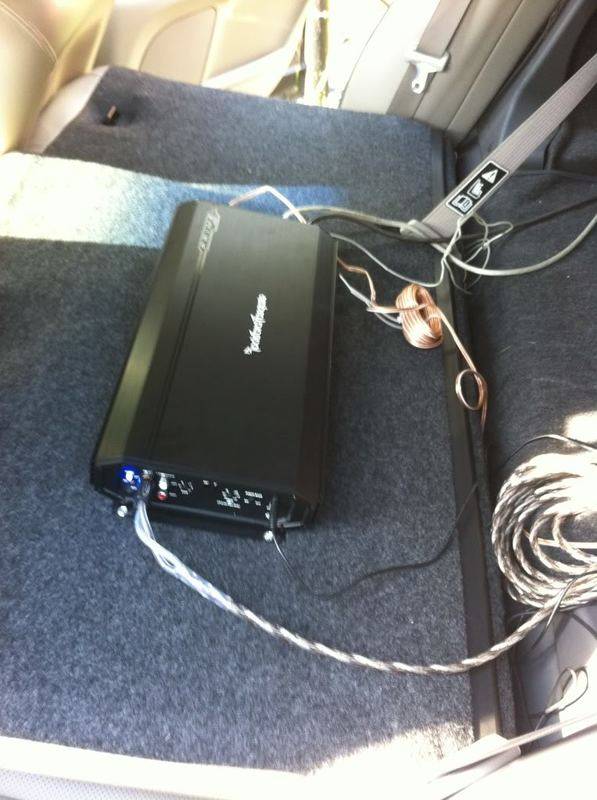

RF 500w mono amp
2 RF Prime R1 12's
Scosche RevoPak 8g amp wiring kit (Nicest wiring kit ive ever used)
Also used a PAC line out converter.
^this cat WILL NOT leave her box now :D
^Everything before installing

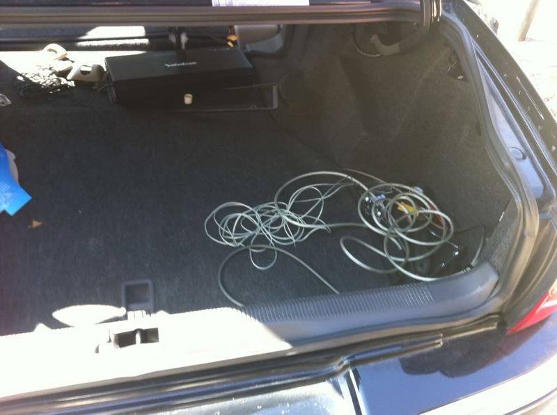

^Everything wired in the trunk, ready to hook up the amp!

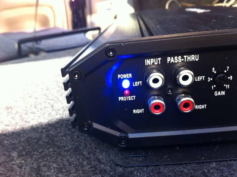

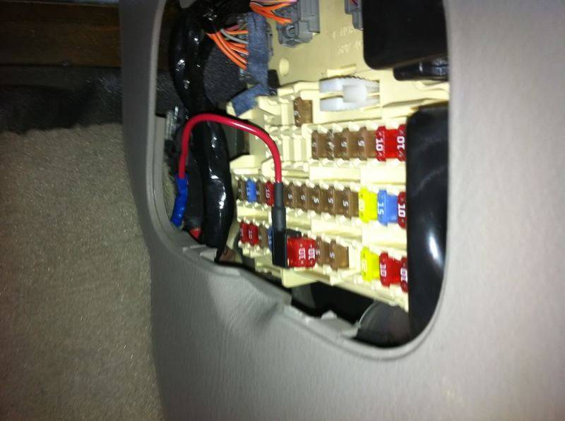

^This is how i wired my remote. Not very conventional but i like how it turned out. This is the fuse for the radio, so now i have a fused remote connection and the radio still remains fused. :D
^After about 45 minutes of playing around i was so happy to see the little blue power light on!

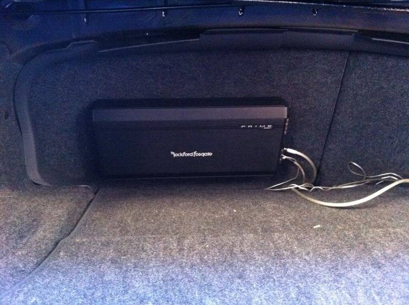

^Finished product :D
Yes i know the wiring is a bit sloppy but i was pressed for time and will be cleaning it all up later this week. :p

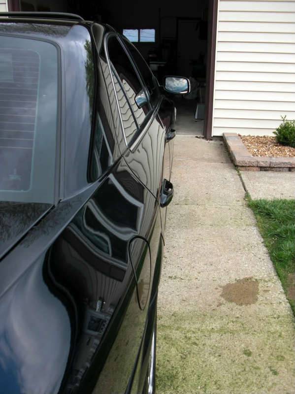

Also noticed quite a few dull spots in the paint earlier today. Did a bit of clay barring and polish and the spots are gone!
Unfortunately, it happens to be pollen season. :(
While I was barring/polishing I could literally see the tiny green specks hitting my car.
It was nice and black when i took the pics and now has a wonderful green hue all over. Not to mention my allergies are kicking my @ss.
Pics of my clean baby!
I really need to go somewhere where I won't get so much reflection off of the body :eek:
Great job, that switch install is clutch.
My ipod cable comes out at the same spot, plug in phone and wedge phone between seat and console = win.

Thanks! Means a lot comin from you! Makes me feel all good inside haha. But yeah. It's right on par with CD quality. I was really impressed. Absolutely zero interference. All i have to do is tune the radio to 87.9 IIRC, turn on the switch, and play. I was kinda sad that it doesnt handle phone calls... Oh well for 60$ im happy.
