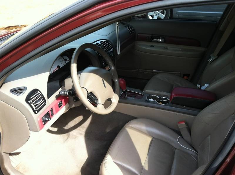

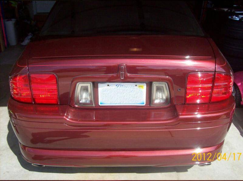

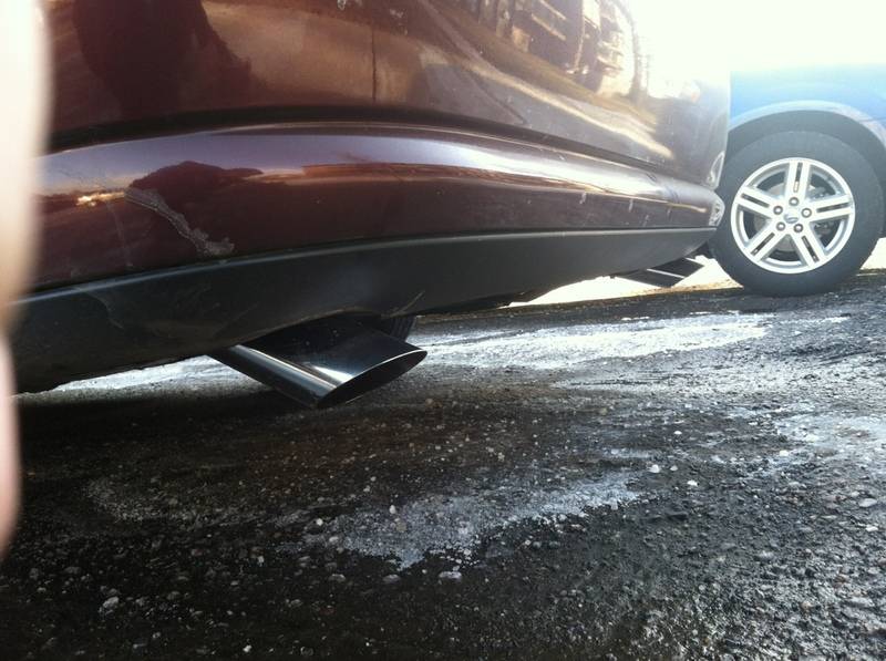

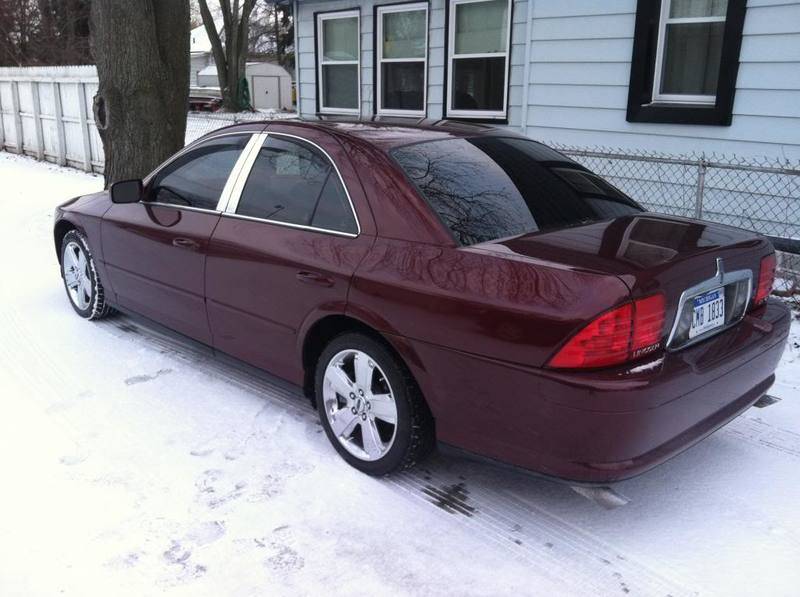

anyhow, here's my list,and a few pictures of my car with random pictures. I'll try to post pictures and projects i get done every weekend.

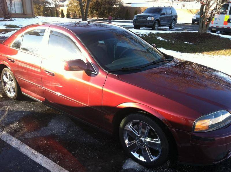

The beginning of "Thre3N9NE" as it sits now.
ugly amber corners :X tinted the fogs and side-markers for now.

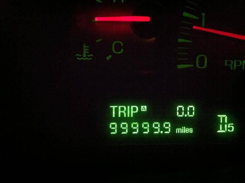

was able to catch it for a picture. this only happens once in a cars life. lol

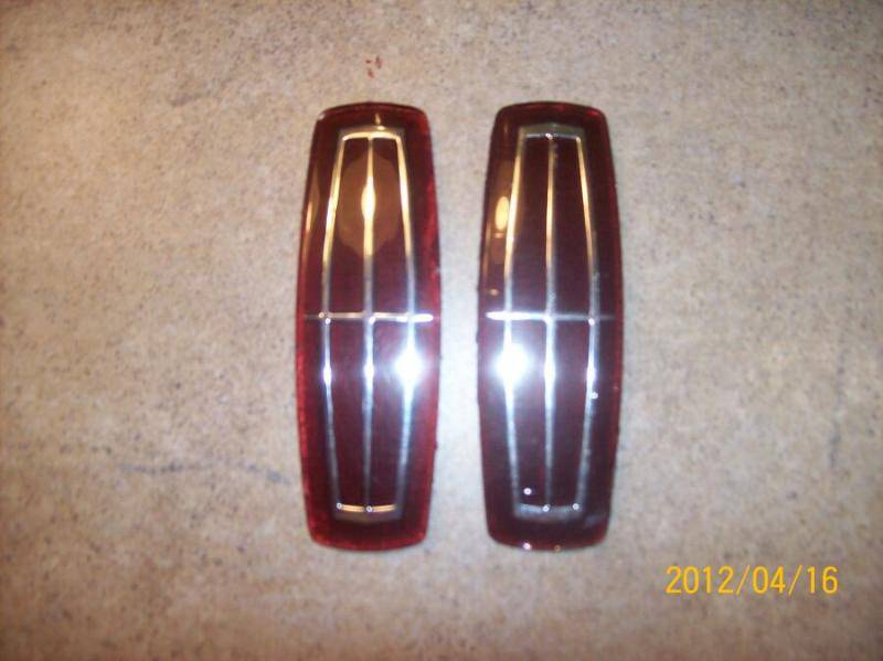

7. Tail Lights
• Tint them (FILM TYPE) - remove emblems.

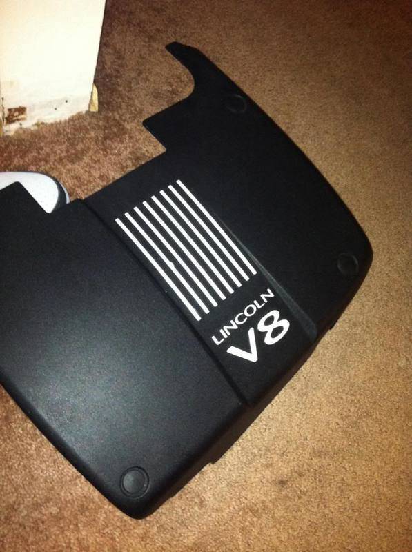

first up, engine cover. probably the easiest thing to remove from the car besides the side defrost vents (they fall off automatically) :cool:
simple for now. just outlined the raised stuff in white. VS. faded silver. thinking of another idea to spice it up. (body color?)
BEFORE:
AFTER:

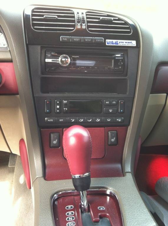

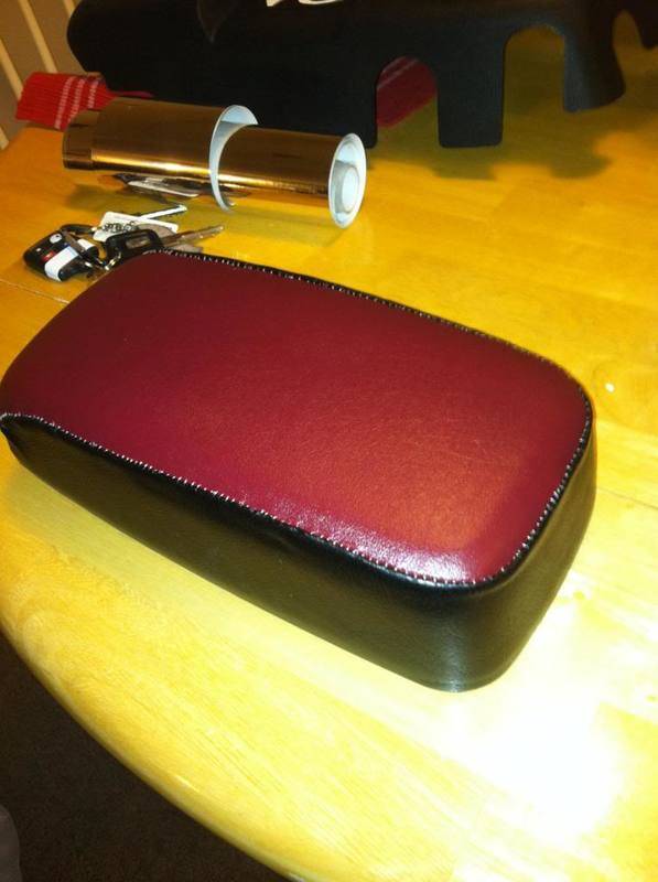

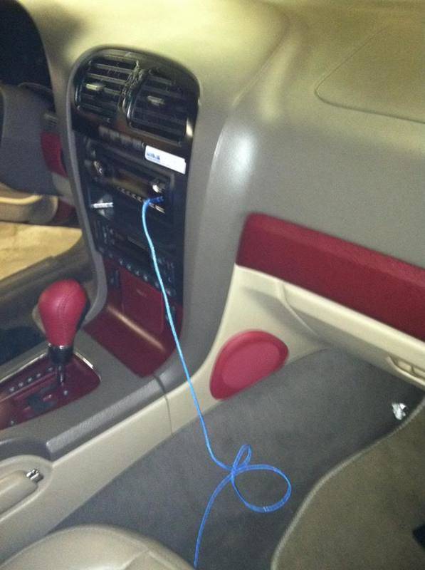

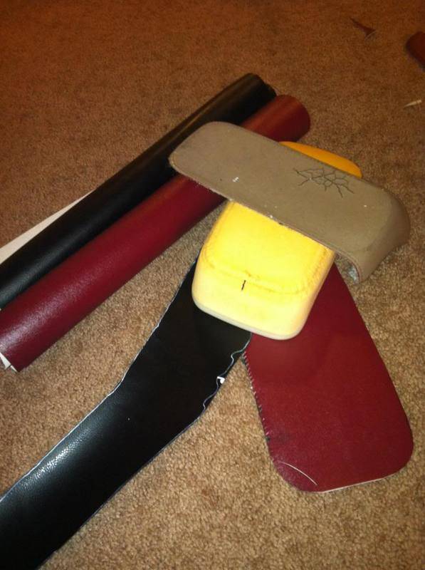

up at 8am. figured it was a good day to recover my center counsel. not sure if anyone else has had this problem... but mine was junk. cracked up, broken stitches, junk. literally the only thing that was flawed inside this car.
now you can see why i was annoyed.
for this project i made my first trip ever to Joann Fabrics, surrounded in line by 20 old women, i bought 3 yards (in case i fudged up) of marine heavy duty leather. black, and dark burgundy. spray glue, heavy duty thread, (white) **going with small white accents throughout project** and large needles.
i went back to moms lessons on sewing pillows for this one. :p

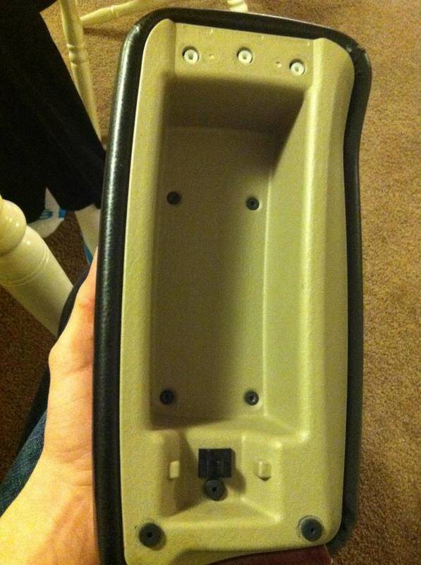

removed the plastic from underneath CC, and pulled out the plastic mold, foam mold, and the cracked leather cover. cut it down its seams (just one long one) you will have two separate pieces. side, and top.
after that, i traced the old leather to the new. leave about 1/4 inch excess (just make sure leather sides are both facing down because one side is taller.) once traced, i labeled each side so it was all put together the same way. then, just sewn together like a pillow. (inside out sides together, and aligned)
in this pic, there's my rough cuts of new vinyl, just to practice i half sewed it together. along with the foam piece.
once you get the full shape, and all the edges sewn together, just spray some tack, and install the new cover over the foam. i did it inside out, and folded it over. (forgot to take a pic) glue was drying to fast.
here is the finished project:
turned out better than i thought for first try. mind you Ive never hand sewn a thing in my life. simple task, just make sure you have an extreme attention from old, to new. measurements, etc.
hardest part was installing the plastic cover again well stretching the leather under it.
cost me a total of 27$
if i can do it you can!
better than the 80$ for a new one :confused::shifty:
one more item off the list. :rolleyes:

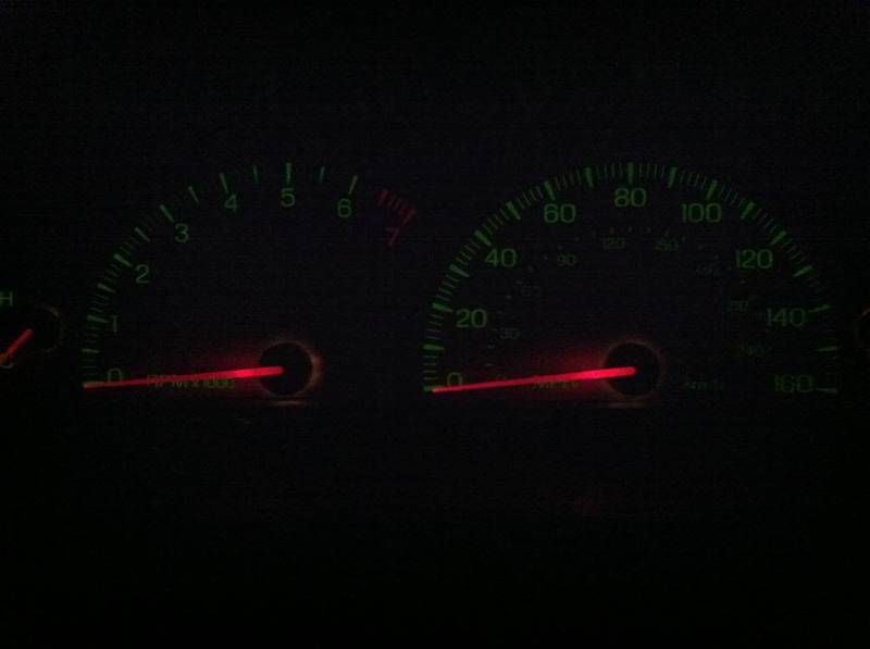

white guages.
i bought the white gauge overlay kit on ebay, and thought to myself, shoot that will be the easiest project ever!
:confused::confused::confused:
what a PITA. i've never had my cluster apart before, so i looked around for removal instructions, but everyone said you have to drop the column down.
if your just doing a gauge overlay install, you don't need to even take off the cover under the steering wheel. BUT, I WOULD RECOMMEND IT. another tip, do it during daylight. i dropped a torx bit into my dash, took me about 25 minutes to find.
just take off the black gauge sight, (2 screws) unscrew the gauge cluster, (2 screws) then remove the torx bit screws that hold the cluster together (6 screws) pretty simple.
easier done with the gauge plugged in, and parking lights on to align the overlays. took me about 2 hours. i like them, but im going to look into to doing a 3rd gen speedo design using only the flexible plate from the 3rd gen speedos.
night shot: needles look much brighter. ;)
woodgrain delete, interior sprice up
IMPO - woodgrain reminded me of my grandpas 88 Buick.
not happenin. not to mention, stock, everything was TAN in here. headliner, seats, EW.
i went with a burgandy Krylon paint (pics make it look pinkish) with a black overspray. did the door panel moldings, tweeter grilles, dash moldings, and center counsel moldings. also the shifter panel, and shift knob (fabric and vinyl paint) turned out better than i expected. nothing more than removing the panels (or taping them off good) and shooting them.

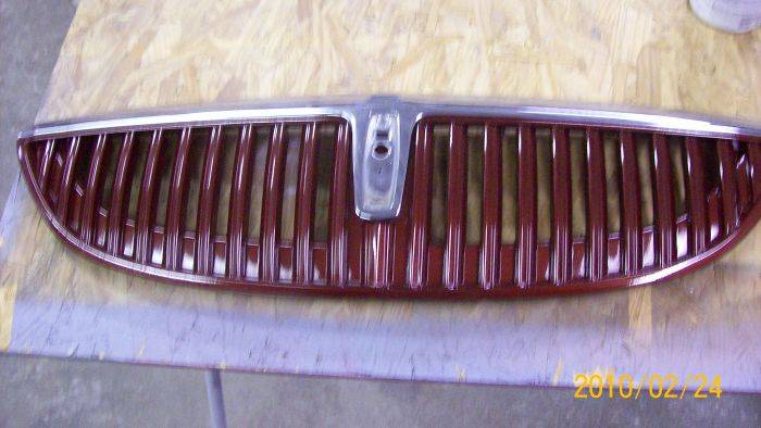

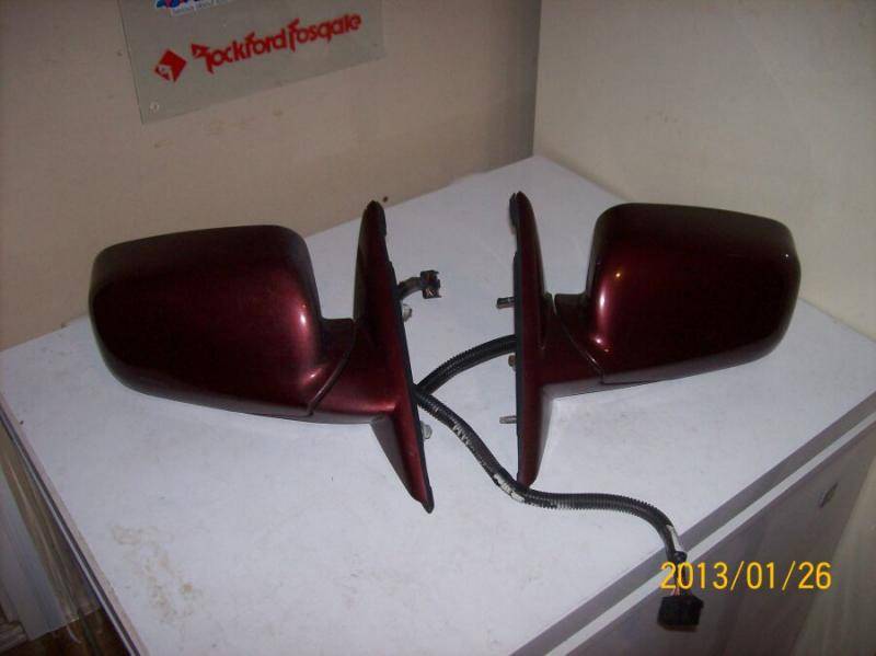

Just give you a few more ideas:

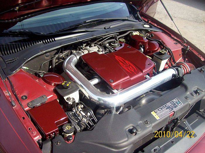

1. Painted and shaved plenum cover.
2. Paint gen1 grille.
3. Other engine bay pieces painted to match.
4. Gen2 mirrors

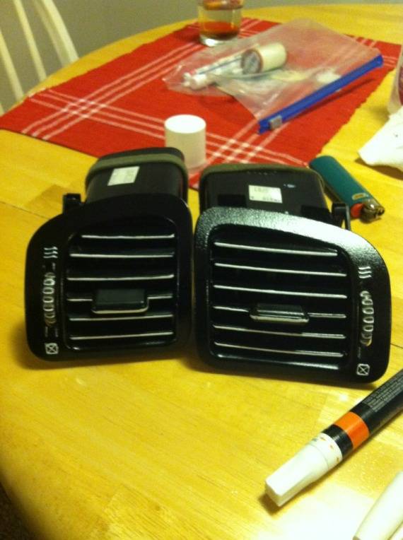

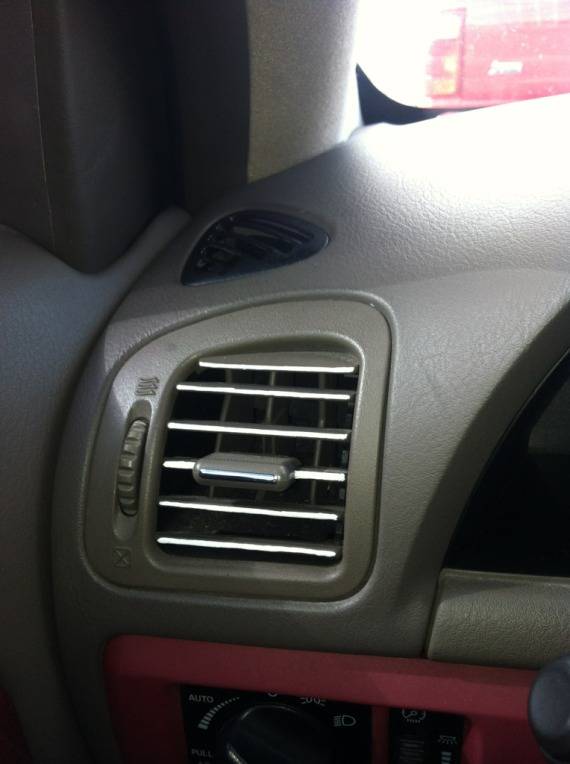

i can only really do small stuff during the week, so i did my vents this week. they were ugly tan, now they are black. ordered my angel eye kit, and LED's today. as well as my MACH1 lower lip spoiler :D
before:
during:
after:

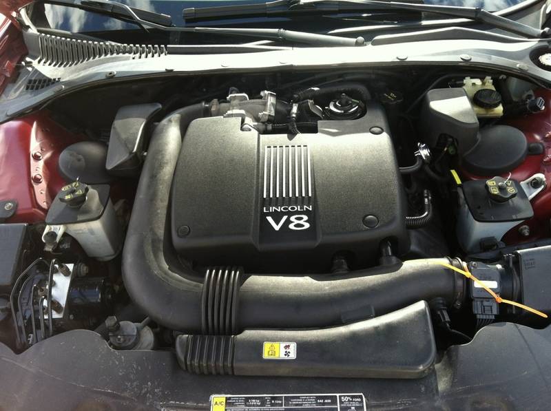

also a shot of my engine bay. plan to paint most cover to match body.. besides that and my CAI, is there any other ideas?
don't mind the zip tie :D it's currently holding my maf sensor down tight. somehow one of my screws broke :mad: will be replaced when the CAI is done, possibly this weekend. ;)
Ordered.
Ordered.
i need ideas for rims guys. i don't want all chrome. and I'm thinking 20's look best. but what about width? and tire ratio? :rolleyes:
Had the same problem, one of the torque screws came out of the housing, new fresh MAF solved that problem.

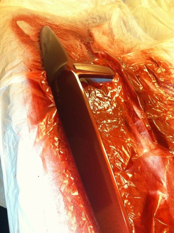

finally!

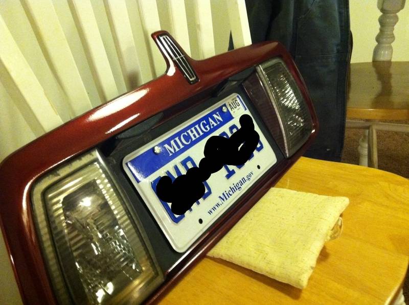

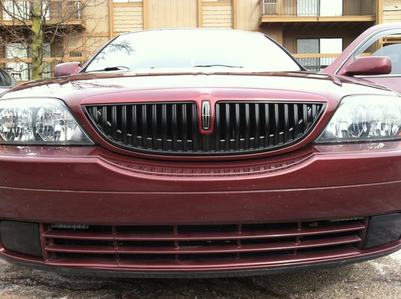

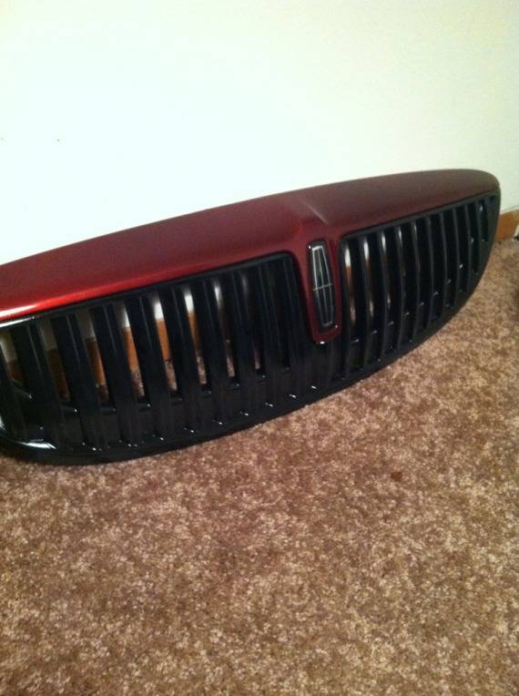

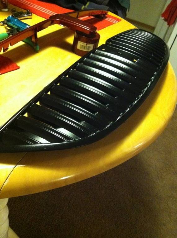

chrome delete on grille AND rear surround!!

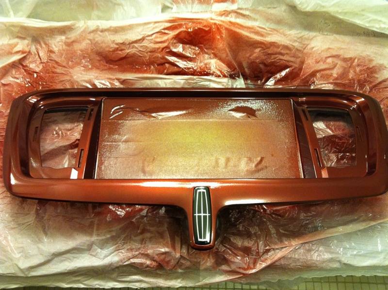

grille, piece of cake.. decided to paint the lower half of the grille gloss black (instead of matte plastic finish) also did the lower grilles gloss black!
surround, a little more tricky to get off, but all went well. nothing broken, thankfully.

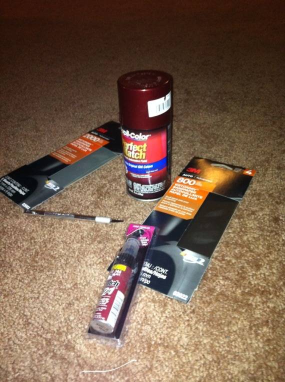

honestly took me longer to find a factory match in a rattle can.
all in all, i cant wait to show you what it looks like on the car! (saturday afternoon) here's pics!
used 800 grit for the little chips in the grille chrome, and sanded them out with 1000, and 2000.
takes some thinking to get apart. there is an order to it.
base coat on the chrome. was a little worried about the color. at first i was like, WTF?! but i came around.
already shining, and this is before clear!!
looks much better!

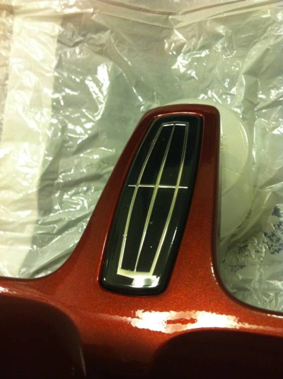

close up, after clearing. there's some small chips in the Lincoln badge, i didn't want to sand on it.
rear surround
finished!
i'll post pics of the rear surround finished, and everything installed this afternoon!
:D
The grille looks great! Duplicolor perfect match is some of the best paint you can get from a parts store IMHO. I have to order it when I buy it, but it's always worth the wait. Did you use an adhesion promotor on the chrome after sanding?
Grille looks great. The OEM Lincoln star shows good contrast. I think you should have painted it too. Just my $.02.
Taped off above or below the Lincoln star. Use flathead screw drver to left it enough to get some fishing line up it. Work the line back and forth till you can pull it off. Some guys use chemicals to get the black paint off the back. I used a light grit sandpaper. I didn't want to have the chrome come off too. I used touch up paint for mine. Your rattle can stuff would probably work better.:)

The rear surround looks fantastic. Not sure about the black Lincln star thou.
Looks real good. What color is that? Where did you get the paint from
Autumn Red.:)
no adhesion promotor, i've honestly never used it unless im doing a bumper that might flex or something. hopefully this holds up...
:shifty::shifty:
Wasting no time, me likey.
Was it a huge pain taping off the surround? My vinyl wrap has shrunk so I might just paint mine as well.
the grille and rear surround couldn't have turned out any better, i love them! totally gave the car a different look!!

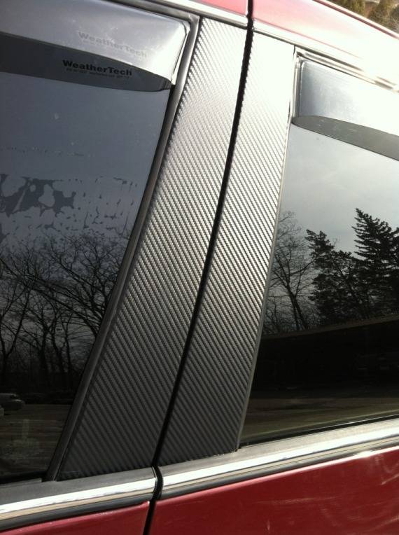

got 5' of carbon fiber vinyl today, did my pillers. just need to find some thinner stuff for the thin chrome around the windows... :confused:
before:
after:

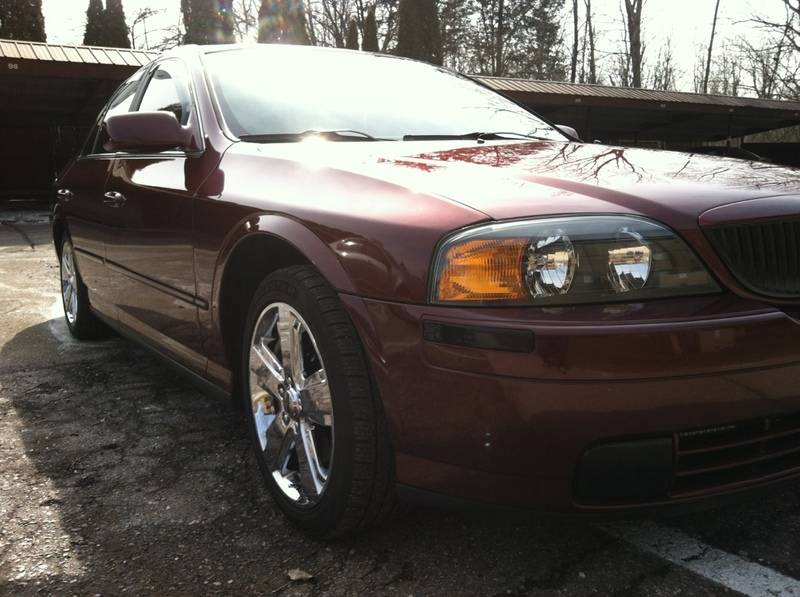

really can't wait to get rid of these terrible orange lenses :runaway:
