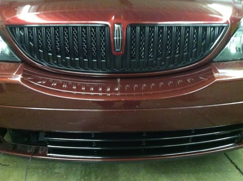

Paint the front lower grille black. Would look great with the black upper grille and the blacked out foglights.:cool:
LS is REALLY coming along fast. Looking forward to seeing the chrome window trim done too.
already got those on my to do list. id have to wait for a warm day to do bumper tho.. unless that lower grille comes off fairly easy?

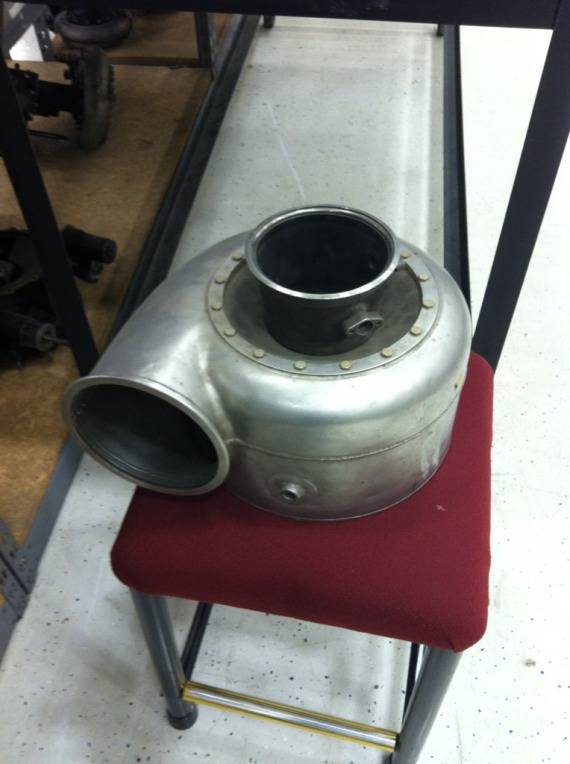

got my turbo in the mail today. bout 300psi at 5,000rpm I'm guessing. have to convert my whole exhaust to 5" to cool it. also cant run my hood. going to need help with this install :p
just kidding, it's actually a turbo from an extremely large gas turbine airplane engine. found it at my school figured I could get a laugh out of someone.

the grille and rear surround couldn't have turned out any better, i love them! totally gave the car a different look!!

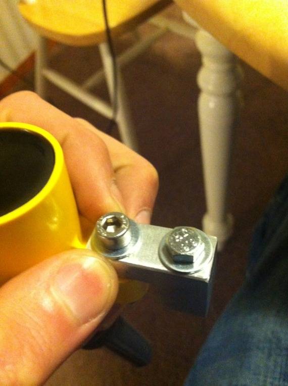

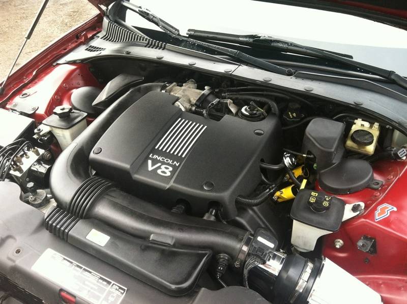

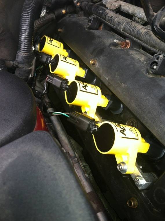

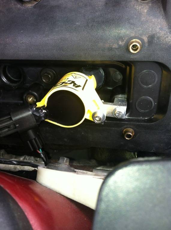

so far today i got my Accel coils in, and brackets made, as well as my harness pins switched, and everything buttoned up.
heres pics.

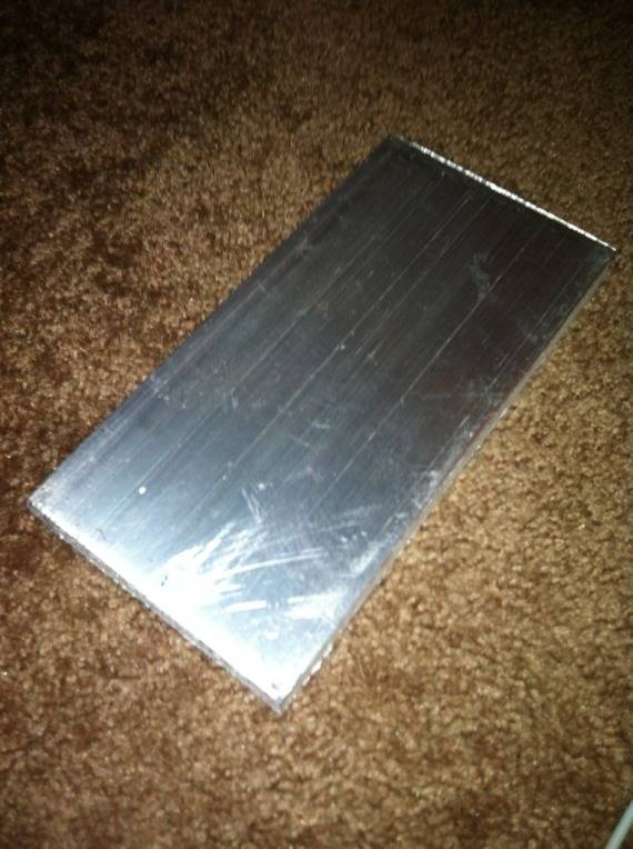

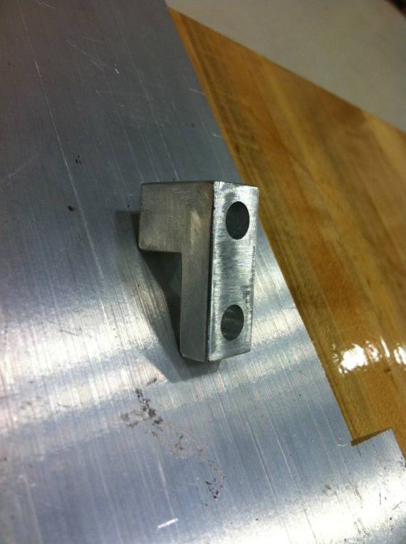

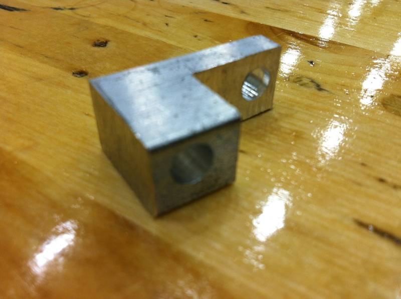

got the aluminum donated by the local steel shop guys:cool:
thanks!
1/2 in
http://i1111.photobucket.com/albums...-AEA7-16CA583E54FB-29697-000010649CED8784.jpg

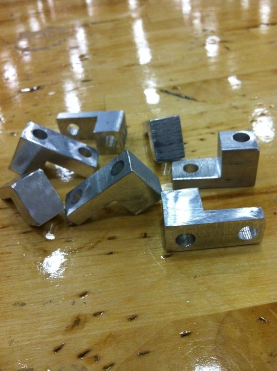

little filing to shine and straighten them up.
bolts i used.. M5x.8x30

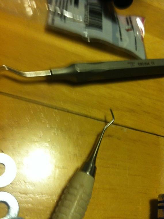

used dental picks for the harness pins

honestly, I would say that tip in throttle to 3/8's is a lot firmer, rest is no different. idle seems smoother, and the tone at like 5k just has more of a controlled tone to it. overall smoother. nothing negative.
Very nice! I mounted my COPs under the aluminum bracket and forced the boot deeper into the plugwell. That way the flange on the boot is down inside and will seal the plugwell even better IMO.
'logs...Were those measurements dead on or what....Nice work!

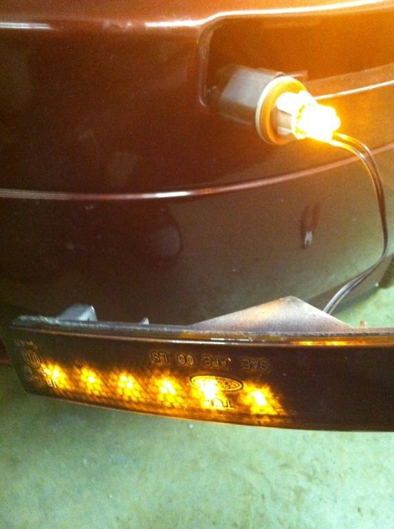

first thing i did, was installed 4in LED strips inside the housing of my side markers. along with the LED pinch bulb.
you can see them in other pics below too.

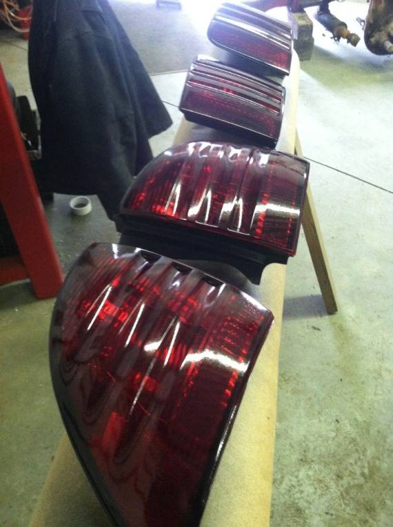

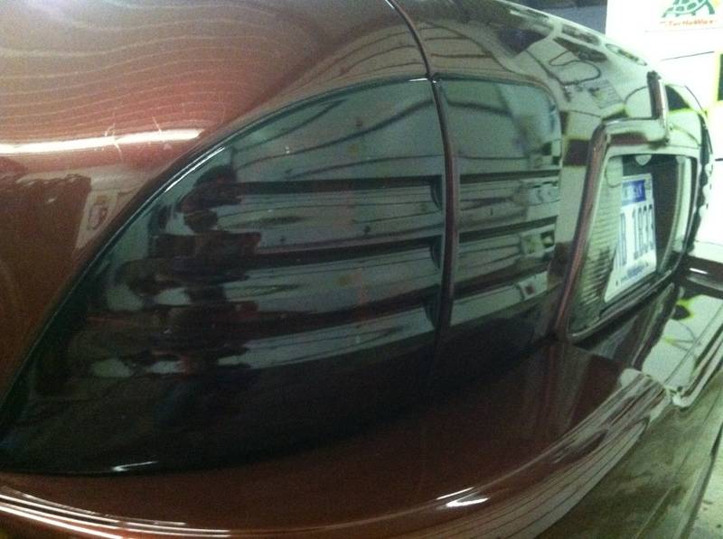

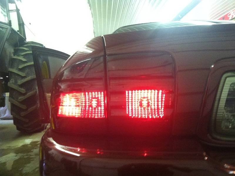

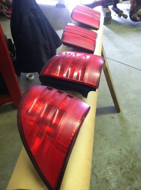

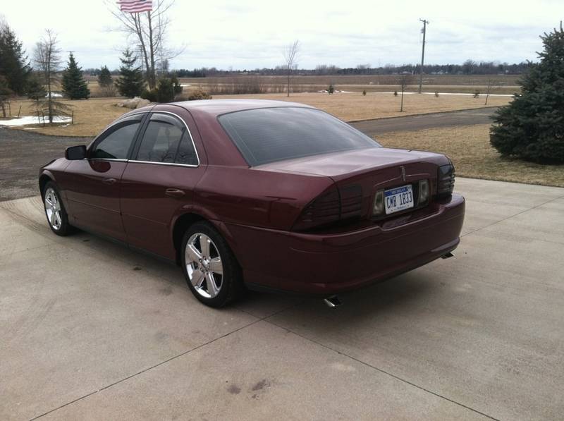

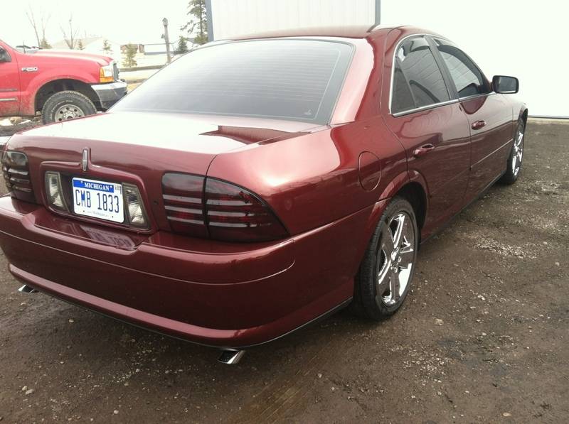

tinted my tails. used VHT and Clear Coat
scuffed them up with scotch brite.

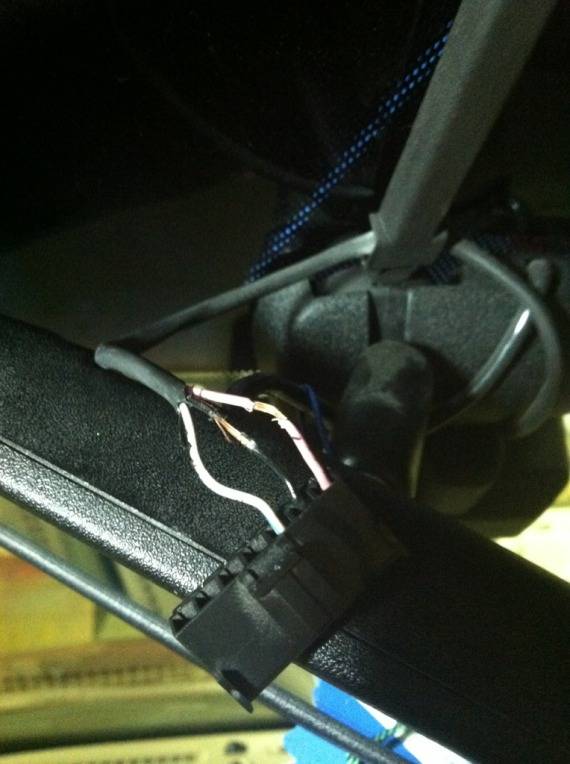

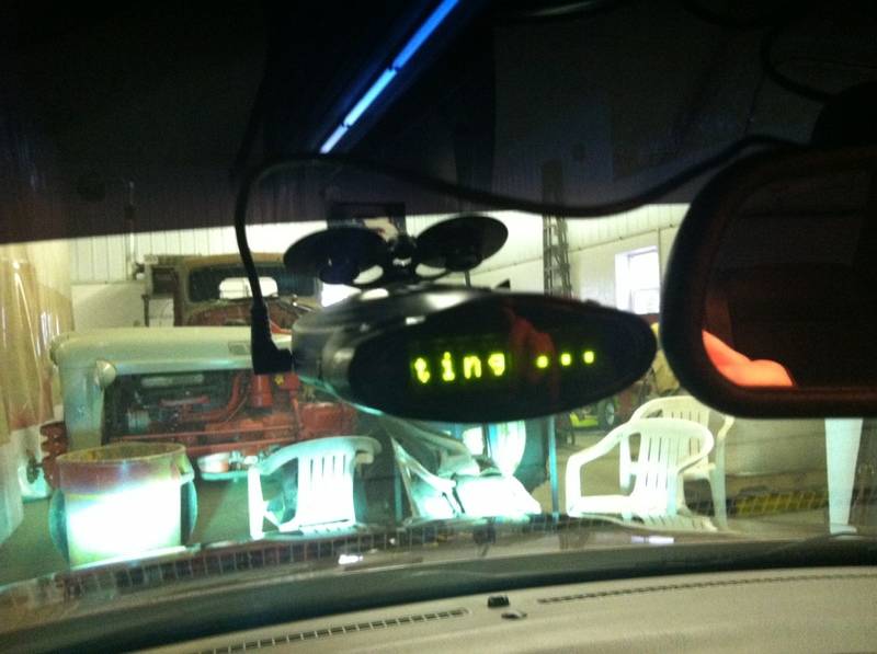

hardwired my Radar Detector to the RV mirror
pink is +
black is neg -

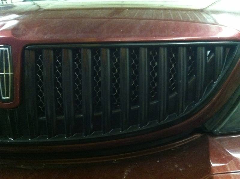

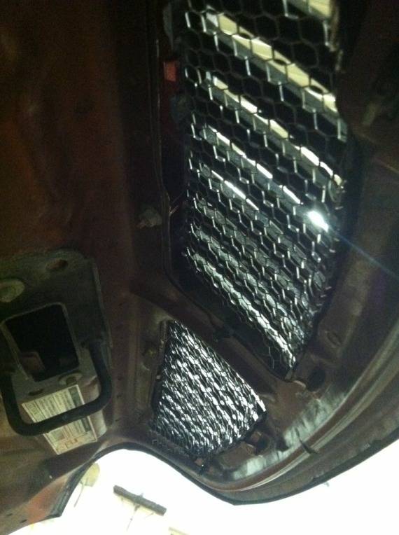

my custom mesh grille inlay.
used masonry lath. 6.50 for a sheet.
very noticeable during the day. check the final pics

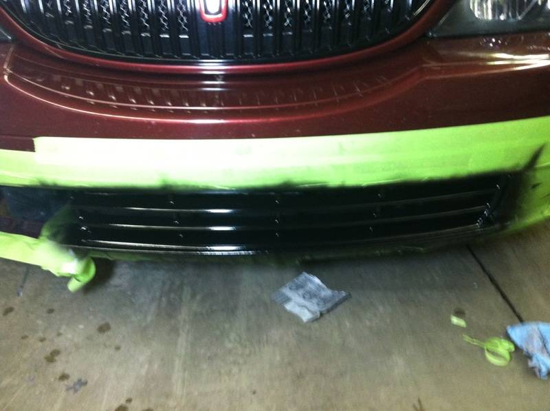

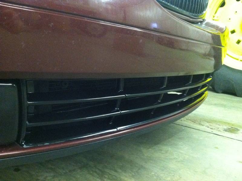

painted the lower bumper black.. scuffed with scotch brite, sanded with 1500.. removed the piece that comes out, which btw..
does anyone know why a section of the bumper is removed??

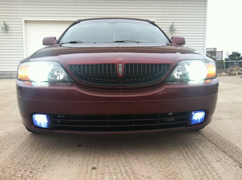

heres how my project sits now. just about done with it, minus rims and Angel Eyes. and any other ideas you guys have :)
LOVE THESE TAIL LIGHTS!!!
I'm not usually a fan of tinted 1st gen tails, but yours look very good!
And that little piece of the lower bumper that comes out is the tow hook cover.
