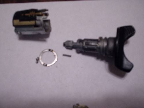

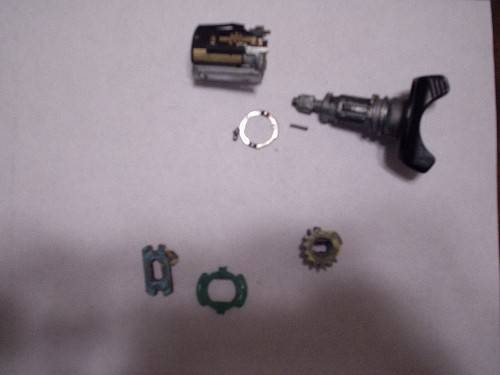

Here is what my ignition cylinder looked like when I took it out. I don't think it's supposed to look like this. Am i correct? Pardon the quality....my camera is a piece of crap

vr4 said:
thats not correct at all.
The cylinder should come out in 1 piece, right?
I should be able to turn the gear inside witha screwdriver and shut it off, right?

the cyl should be 1 piece but due to the design of the system you cant just start it with a screwdriver. that gear looking thing is what the end of the cyl goes into. it actuates the rods we were talking about being broken.
see how the end of the cyl has the odd shape to it. the small part slides thru the steel plate that was holding the gear in. this is why you cant just use a screwdriver. the plate doesnt rotate but the gear needs to.
