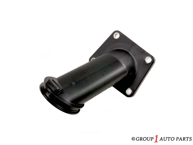

Hey been following your posts and I got to say she looks beautiful! Great job with her, you gave me hope on fixing mine up. I was hoping you can help me out please, sorry for taking up any of your time and any help would be greatly appreciated.
I bought my 2006 LS last week 146k on it and it overheated on me. I've been researching as much as I could so i'm changing the thermostat, the housing for it, the back part of the housing. I want to change the dreaded 9N499 elbow piece behind it but im not sure how to go about cutting the bolts with a rotary tool. I saw that you did a great job hoping you can help me out. Do I just unscrew as much as i can and cut the screw in half and use a pliers to spin the remanding piece out...? I'm a bit lost. Also is it okay to be making sparks under the hood when cutting the bolts off? Should I be shutting of a gas valve or something? Don't want to start a fire. This is literally my first time working on a car, sorry if my questions seem dumb. Again thank you so much for taking the time to read this and any help you can give me!!
Why so resistant to taking the intake manifold off? It's not hard, and then you wouldn't have to remove the throttle body from the intake. If you remove the manifold, you can vacuum out the dirt that is going to fall into the intake ports. (I suspect this happens when you just loosen it and lift it slightly too, but this way you can get it back out.)
The original thread OP has gotten rid of his LS (I think BigRigLS has it?).
But yes, you back them up as much as you can, then slice them off. I used a cutting wheel on a dremel. Sparks under there are no problem, just wear eye protection.
Be sure when you replace the bolts, to use the same bolt part# from the thermostat housing assembly - they are the perfect length to use correctly.

Thank you both Joegr and Andrizzle for taking the time to read and help me out. I really really appreciate your quick response!! My car is in pieces and my only transportation so im stuck till i fix it and haven't had a single day to drive this beautiful car since I got her.
I dont want to mess with the manifold because looking at this write up it looks like a ton of work and im not to familiar with engines unless im looking at the wrong write up? Not some one to shy from hard work just dont want to have more options of things going wrong.
When I cut the back two bolts do I need to remove the Throttle body as well? I got off both front and back of the housing up till the elbow off without removing it the throttle body. When I cut the bolts do I cut half the bolt and unthread the rest by hand? Is any dermal ok to use, any specific size head for it? Thank you I will definitely get the bolt for the housing to replace these. Sorry for all the questions
It (manifold removal) looks worse than it is. It's just some grunt work. No special tools (other than fuel line disconnect $5 tool) and no special knowledge required.
If you don't remove the intake manifold, then yes you have to remove the throttle body from the manifold. It's not difficult either, but be careful of the gasket between the intake and the throttle body. You can't get a replacement one anymore.
Make sure you get the replacement bolts before you cut the ones you have. I'm sure that once you cut the bolts you can lift the pipe off and it will be easy to get the rest of the bolt out.
Note: On one (2006) of my two LSes, the throttle body heater hose was starting to fail. This is very very difficult to see and to replace without removing the manifold. (However, it was and still is fine on the other LS (2004). I have no idea how often this happens.)
Thanks for the heads up. When I took the coolant outlet pipe out, the back part that connects to the elbow (9N499) has a white goo type substance on it. Cant tell if it was some type of sealant used to stop a leak or something or if its supposed to be sealed up like that from factory or possibly the plastic disintegrating from the part. Am I supposed to seal it up with anything besides the gaskets? How important is it to torque the bolts on exactly at 89 lb-in, I ask because I do not own one and wondering if I really need to spend the extra $50. I read somewhere that if you add an extension bar the actual torque changes is this true?
Torque on those bolts is not critical. You want it tight enough that they won't vibrate loose, and not so tight that it cracks the plastic.
The white stuff is residue from the coolant leaking there for a while. There is no sealant to add, but be sure to lubricate the seals before installation. Coolant or silicon spray works for that. I wouldn't use oil (but it might be okay).

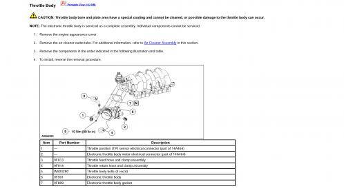

Throttle Body Removal
Wow thanks for the info LSFRANK makes me wish I got on this forum a lot sooner. Sorry for the thread jack but I need help and these guys know what they are talking bout.
Is this the right write up for the removal of throttle body...? I feel like it should go one more step all the way to the intake manifold like you said? Does anyone have the write up for this thanks again!
