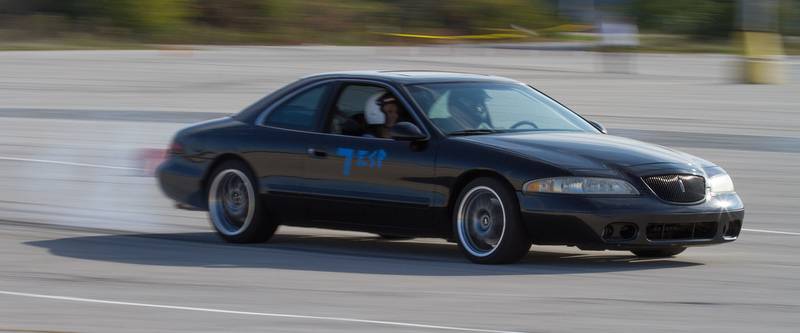

I should have some pictures up soon of the Autocross event this last Sunday. It was a riot and the "crowd" really enjoyed the Mark VIII.
I did okay, placing 3rd out of 4th. Beat a Fox-body that was much more setup than the Mark, so I'll take that. On the last two runs, I developed a high-RPM stumble. I'm thinking it's a fuel problem, as I haven't put a new fuel filter in yet and the car probably hasn't had that much lateral movement in it's entire life.
I managed to locate some Koni's finally, so those will be going on sometime this winter after I figure out what springs to use.
Really the only picture from Sunday that turned out. I need to get my trac-lok installed badly.
