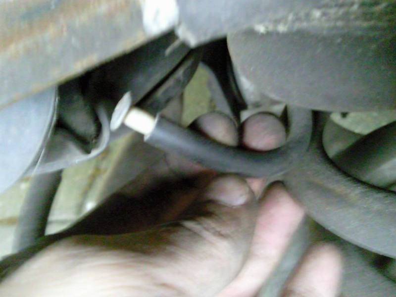

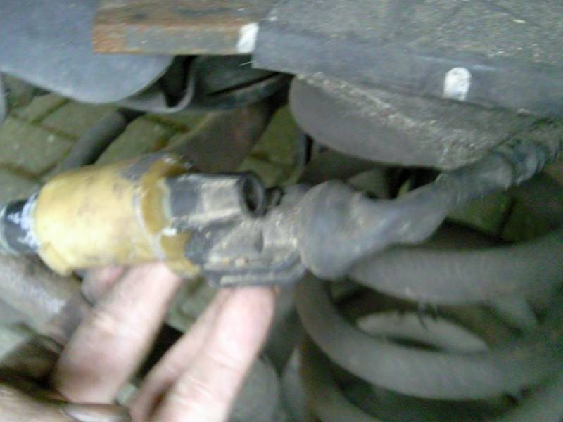

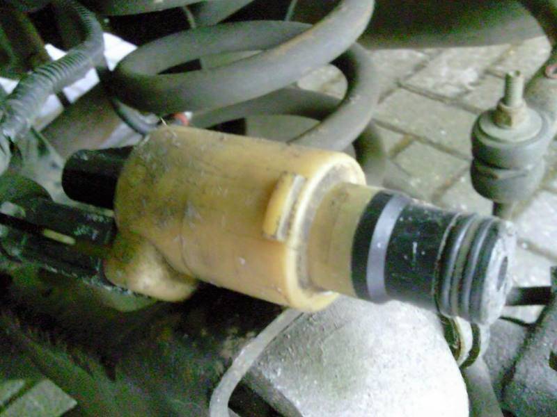

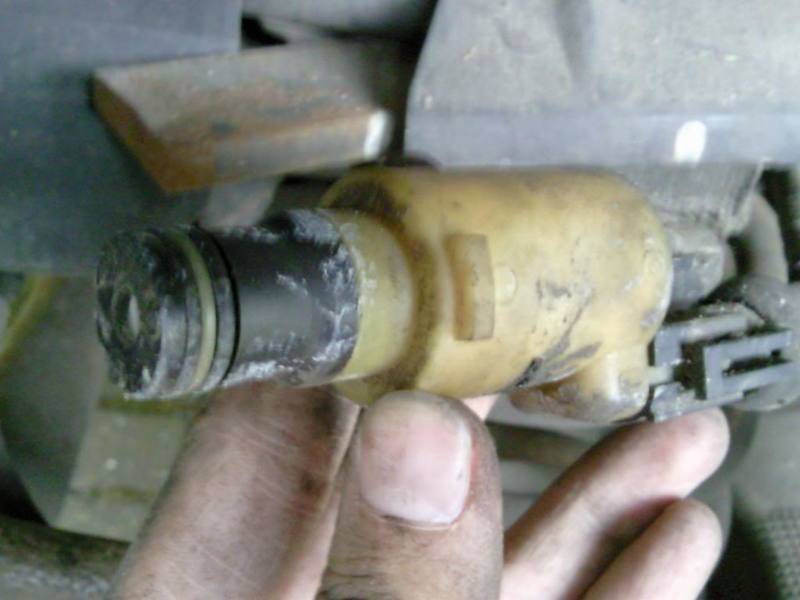

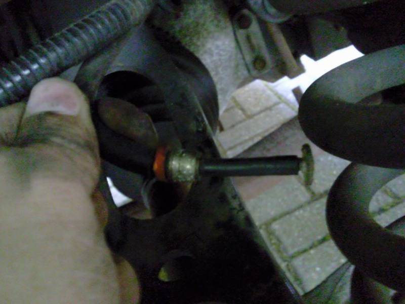

2.): I want to replace the springs with bags and wanted to check whether I have to replace the solenoids as well or not. If I compare my solenoids with this http://thumbs1.ebaystatic.com/d/l225/m/mvAc4czvPrjNz31ZNUR-HGQ.jpg one for example, I notice that the red ring on top is missing. That red ring seems to be on the line now. I assume its not supposed to be like that and the solenoid is unusable now? Everythings thats under the red ring is completely missing on the passenger side as you can see in the photos:
drivers side:
Also, I thought thats just the wiring harness for the solenoid? For some reason it leaked a clear red liquid.
passenger side:
I have about zero experience with airrides so maybe you can tell me whats reusable and what should be ordered with the springs.

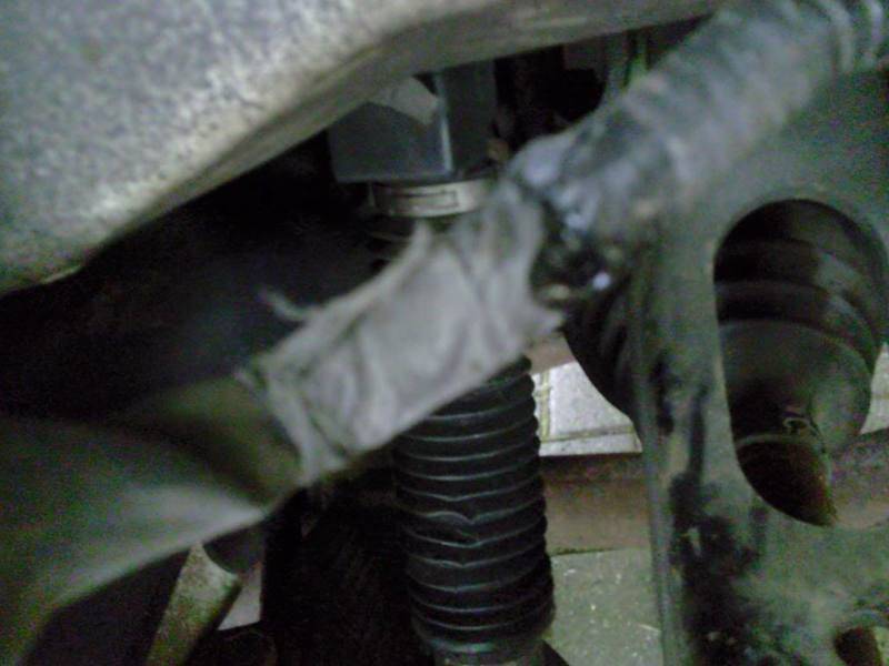

3.): And the front. The previous owner (who also installed the rear springs) changed the upper control arm on both sides. I thought the clunking might be coming from the sway bar. Turns out one bolt of of the uca on the passenger side is barely attached to the chassis!:shifty: The nut thats supposed to be holding the bolt in place actually isnt really on the bolt, I dont even know how it stayed there, you can stick one finger right in there so I am surprised it didnt fell off yet!! Its hard to make a photo but you might get what I mean:
Its hardly touching the thread of the bolt.

Anyone here know if I can reuse the solenoids or should I order new ones with the rear bags? Also is AAS shipping to the UK?
reuse the solenoids with new orings and some silicon grease.

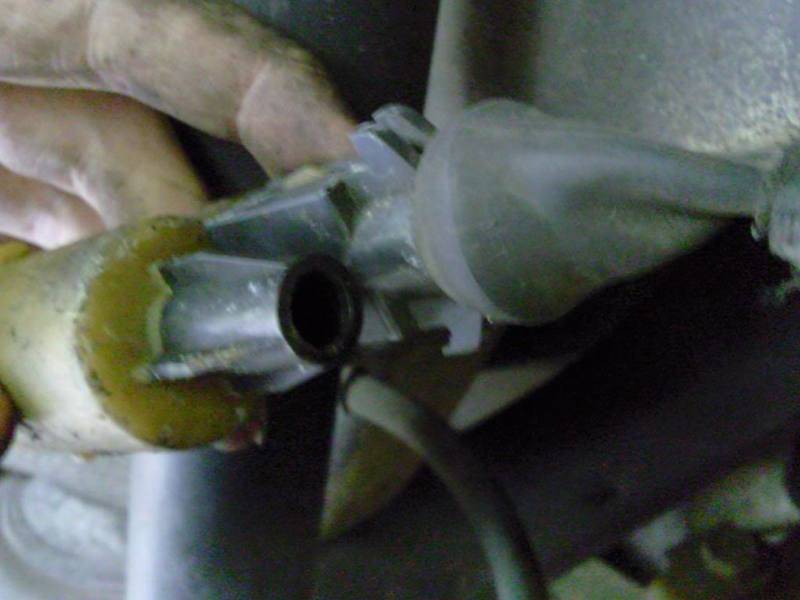

What about the stuff in the red circle, isnt that supposed to be in the solenoid? Its missing on the other side and I guess its nothing you can order separately and would only come with a new selonoid?:confused:
Nah I mean its completely missing on the passenger side, including the metal ring and thinner piece of line next to it. Seems like someone just cut through the line. The photo above is taken on the drivers side. Is that stuff supposed to stay on the line or is it part of the solenoid, normally not detachable from it? It just seems like the line was ripped out of the solenoid damaging it. Thats why I am not sure if I should just get new solenoids. It would take ages to get new ones shipped from overseas should it turn out I cannot reuse mine.
Get new ones
They are a smc fitting it stays in the solenoid
Only the line should come out
