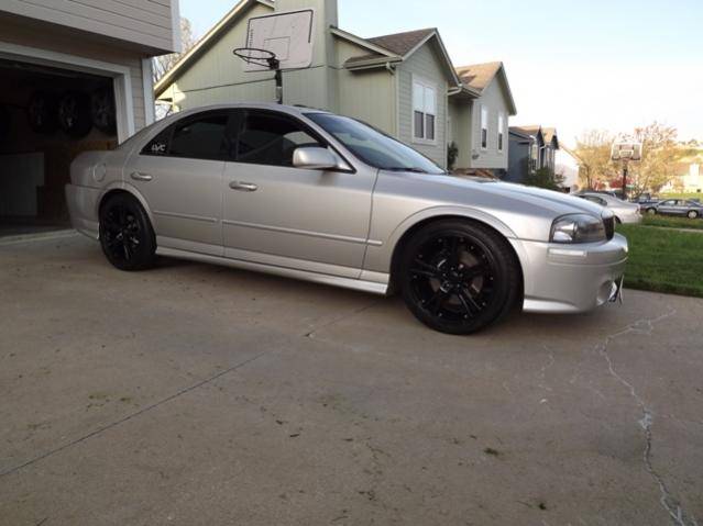

My new LSE

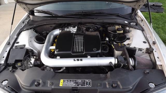

Did alot of work to the LSE this weekend:

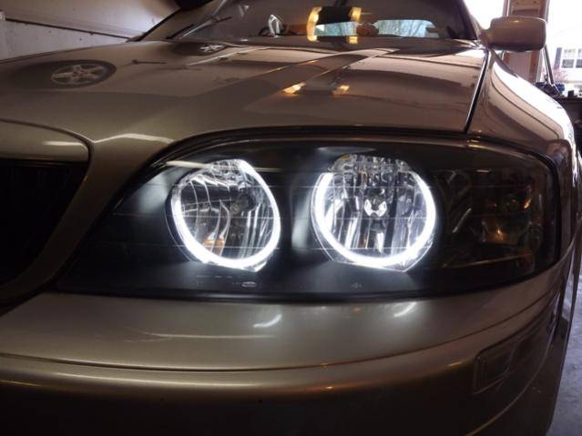

Refinished headlights
Repaired a loose angel eye
Installed new upper control arm

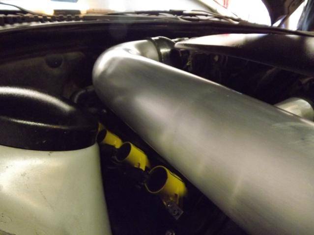

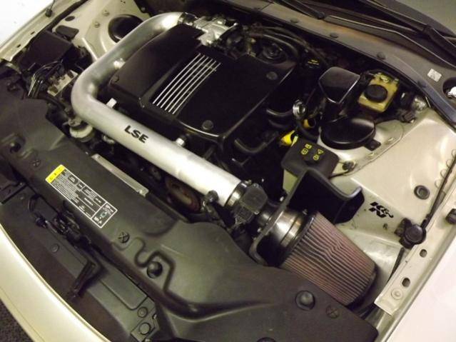

Sanded the ASMI intake tube
Installed new woodgrain steering wheel

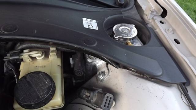

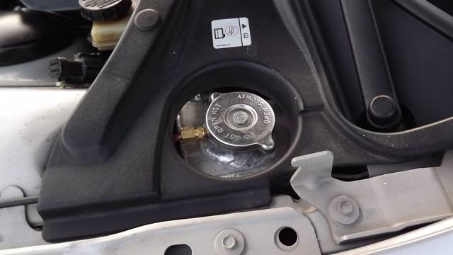

Installed Custom aluminum degas bottle

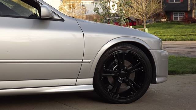

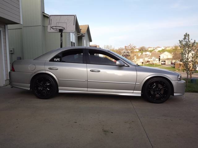

Touched up paint on wheels
Washed and waxed
That is some awsome work! Very jelly of that degas bottle :p
Car is beautiful Hite.
