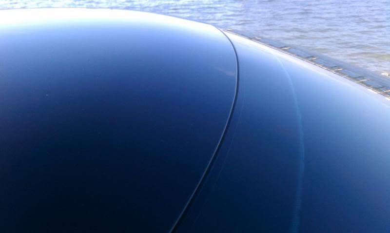

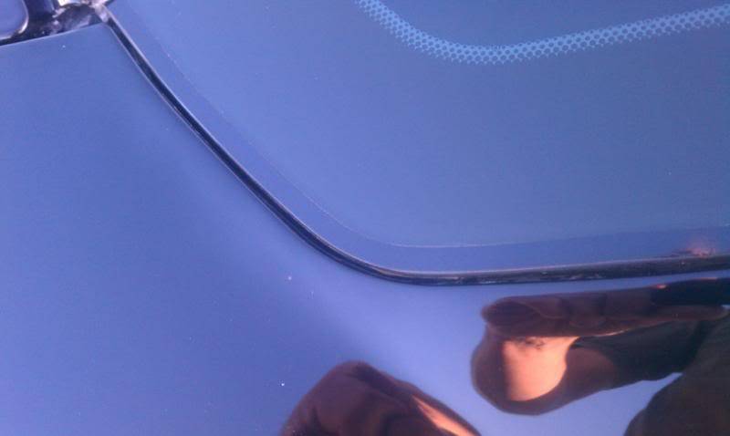

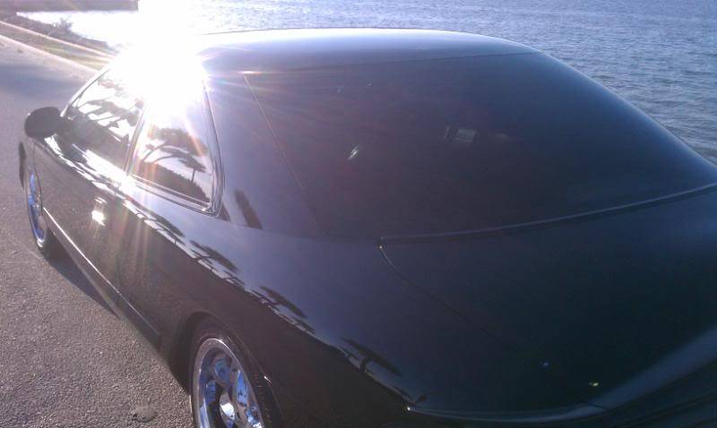

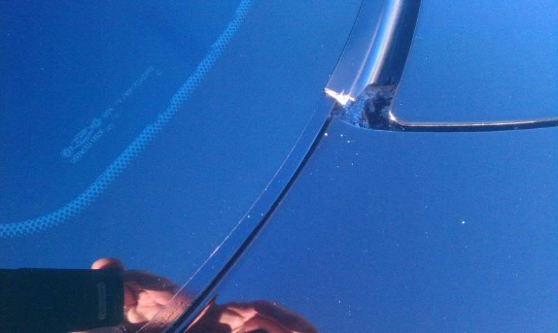

Looking at the pics, it looks as though the rear window has no gasket around it and it was done that way by design. If that is the case, it looks good. How did you do it?
the rear window gasket started to wrinkle up.so i cut it off,welded new metal in place,filed and filled,not an easy thing to do,there is a 1/4 inch of space between the window and body.still have to make a panel that goes between the trunk lid and glass.sorry didnt take many pictures,when i start something its always full steam ahead.
The rear window seal shave is what is killing me on Stacks mark.
Whats givin you so much of a problem? My rear window had some sand between the glass and the seal causing scratches on the glass,so i just put a 1/4 inch pinstripe on the glass.My thought was originally to extend the trunk lid back toward the window,but after thinking about that it would be easier to make a panel to go across instead.ill take some more pictures today of the rear window to try to help you out.
I did it wrong, made the channel too small and shattered the window when I put it in... I made a filler panel at the bottom...
So I had to cut the ENTIRE thing out and start over.
