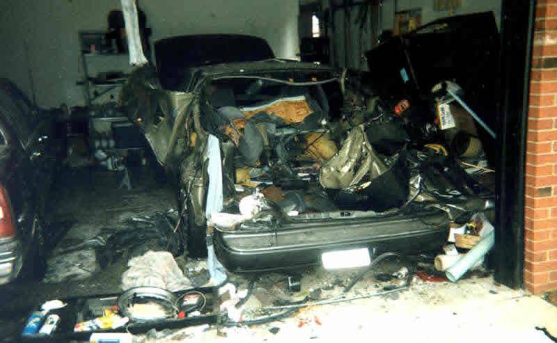

This is why nitrous is a fail for me. Dude's car was in his garage doing nothing, didn't even get the satisfaction of blowing it on the track...
An improper setup is asking for trouble. A lack of a properly installed pressure relief valve can result in pics like this(on a very hot day).
If this is the car i'm thinking of he left the bottle heater on all the time while car was in garage. I also think they messed with the relief valve. Proper relief valve and blow down tube and it just release NOS out of bottle to ground. I did learn lesson never leave a full bottle in the sun a long time. Bottle shot off like rocket(relief valve doing its job) and ran into my compressor.
