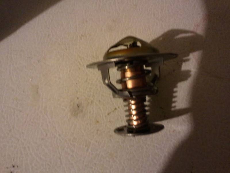

Just pulled the T-Stat (Moderate PITA), and this is what it looked like. Coolant was cold. It's a MotoRad T-Stat
Edit just tested it by boiling, and it open, and closed

What temperature number is stamped into the bottom of that thermostat? If you flip it upside down there will be a number stamped into the copper slug inside of the hole.
I recently had a problem when I purchased a 180 degree motorad thermostat from autozone, my box was the right part number, my car is tuned for it, the part looked correct, the receipt was for the right part, I installed it correctly and bled/burped it correctly, but after it was installed I couldn't shake an overheating issue.
I burped and bled the cooling system countless times each with little or no help. Eventually I got pissed off and bought a high flow 170 degree unit for a cobra. When I removed my newish thermostat I found stamped into the copper on the bottom 200 degrees. So the problem the whole time was that the part that looked correct was in the wrong box and was rated for the wrong temp.

Just looked under the thermostat, and it said 195*. Should I use an 180* t-stat
Mark VIII's come stock with a 188* t-stat. If the one you took out is a 195*, it's the wrong Tstat for the car. I would think a 170* would be a nice cooler tstat if you want to go that direction.

I just put in a 180* Tstat from NAPA, bled the system, and it seems to have fixed the problem. I drive it around for about 5 mins, and the temp stayed between 186-190*. When I gave it a mid throttle push, the temp stayed the same (at around 188, and go up crazy like it did last time). Do I need to do anymore further test or am I good to go?

Sounds like you've got 'er fixed! Check the coolant level after you drive it a while (after it cools) to make sure it doesn't need a bit more.
