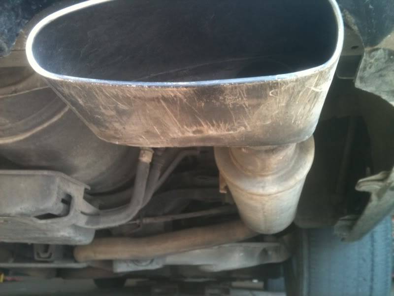

I also cut off the mufflers and extended the pipes and remounted my stock tips. I'm also running a double x in place of the third cat. I get compliments.

and before someone else mentions it..I know my tires are bald..those who wish to nag me about it can also feel free to help buy new ones
thanks and LOL @ "and before someone else mentions it..I know my tires are bald..those who wish to nag me about it can also feel free to help buy new ones"
I'm poor...that's what's up with them...I have considered buying new ones.. I've also considered finding a better job, and an actual house instead of an apartment.. I've considered buying groceries a few times (sometimes not even for me)...right now I'm happy that it has a full tank of 93 in it
I'm saving for tires (that's my next mod) yay 1 down 3 to go
Was just bustin' your balls..
