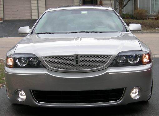

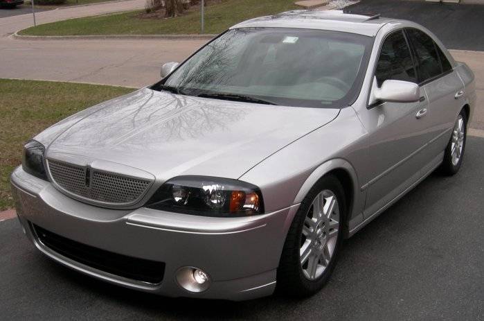

What do you all think? Very easy upgrade. Less than 2 hours to do the swap.
Looks good. I would like to see what it would look like to get a piece to match the Mclaren for the lower grill. Have fun with your new 06 LS!
itsnotmydaddys said:
looks good u got a b4 pic. what did it cost u

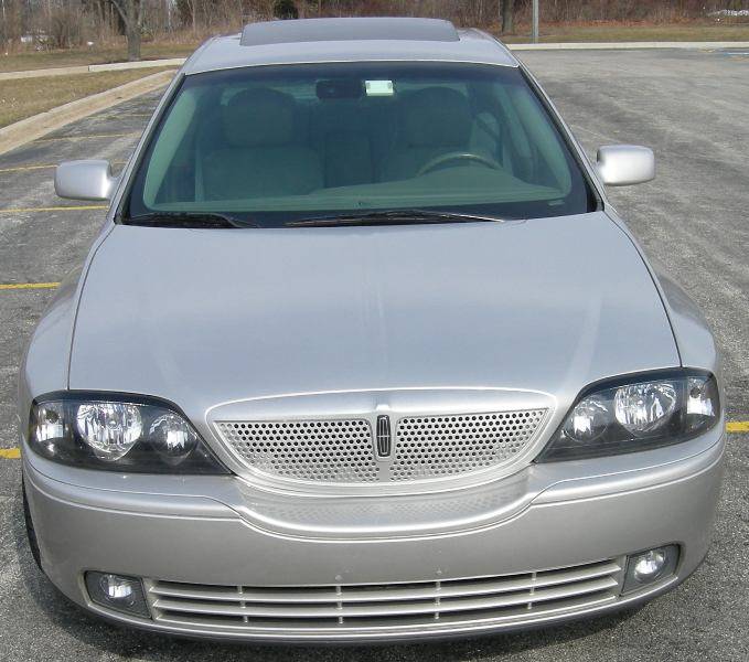

Here you go before and after. Cost me about $700 to convert just the front bumper and $1400 for the rest of the LSE kit.
where did you get the kitt from i want to convert my 04 to a 06 too and also the the parts come pre-painted or did you have to have it done yourself.
I got the front bumper and fog lamps from our vendor here on LVC Bill at Team Ford, the rest I got from a local dealer. I had to get it all painted myself.
Thanks 01lssport! That would look pretty cool with a lower McLaren grill. Have you or anyone else seen one before? I have not. Would love to see one for the LS.
