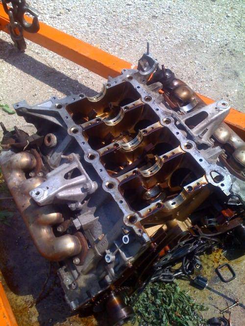

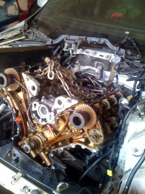

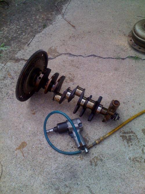

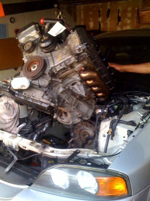

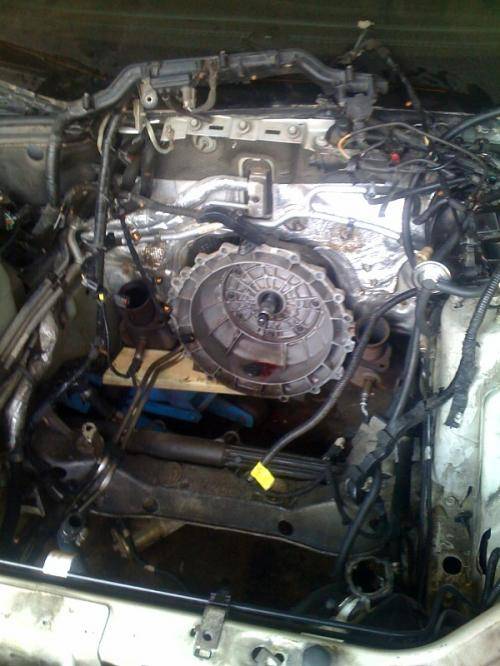

the car is an 01...pulled it from the top with torque converter still attached since the old motor was locked solid. after that we had to strip the old block down to get the converer unbolted. its an 80k motor from a late 02 with the upgraded chains and tensioners only thing that was different and needed swapped over was the oil cooler.me and my buddy did it in a week of half days. have 400 miles on it so far no issues or cel :)

Well the build date on the car the engine came out of was 01/02/02. every other 02 car they had out there were actually made in early to middle of 01. i should have taken pics of the difference in the chains and tensioners from my 01 to the 02. im sure the build date of the car doesnt mean the engine was made the same day or anything , so with that said im sure if your car is an 02 it has the revisions and also after what ive seen id never buy a 00 or 01 car and rely on it to last. the 02 has more of a crosshatch style primary chains that look very stong and the metal tensioners with just plastic on the ends for guides. the 01 engine i pulled had more of a motorcycle looking primary chain and all plastic tensioners which is no wonder why it had failed very miserably and sent a valve thru the piston.

i really dont mind the vent :q:q:q:q talk,but atleast have some pics loaded of your own car first to prove it isnt all ragged out. but really the point of this whole thread was that when you look for a replacement engine for your 00 or 01 for some reason they say its those two years only and they are $1300-$2000 and was told by several yards that the 02 wont work (even tho its the same gen). this prettymuch speaks for itself and only paid $900 for it and if in a pinch they can be had with more miles for $650 and theres definately alot of nice 00's and 01's out there that can be bought cheap blown up and brought back to life. that is of course if you have the time/patience/skills/and tools.
