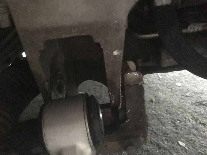

Rear bushings in the middle Of this picture. I saw the crack/split and didn’t look any further. Ordering these too.

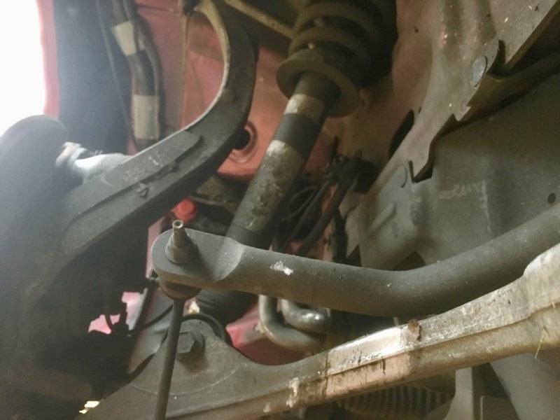

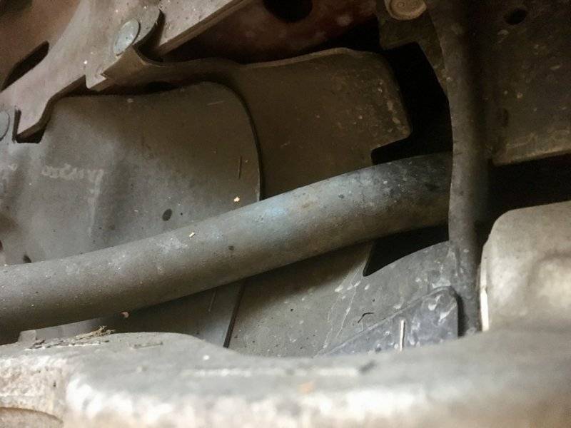

Sway bar going into body:

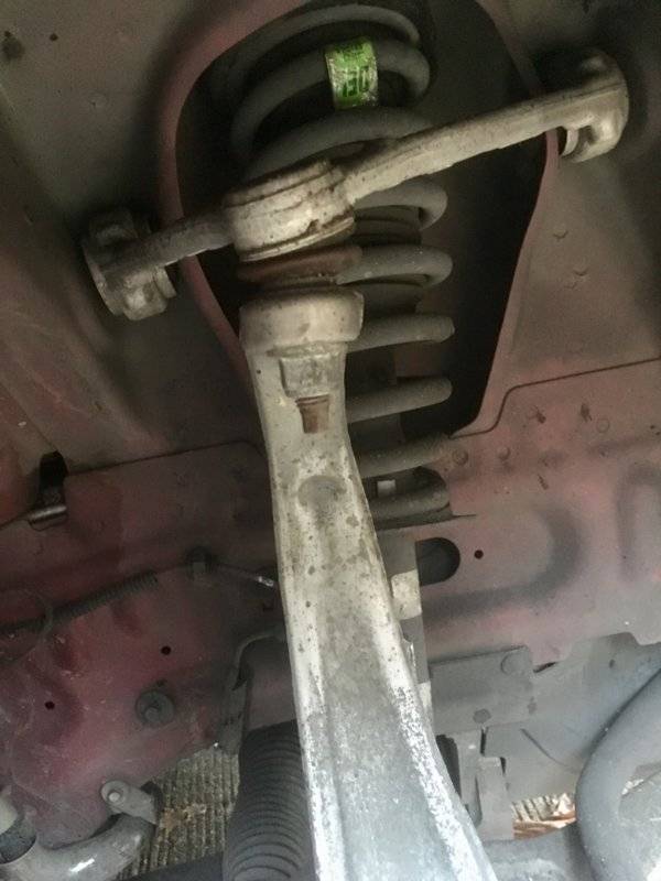

I was trying to see if the shock is straight.

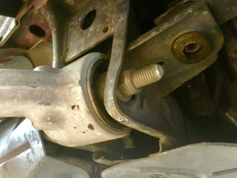

Lower control arm front bushing:
Your sway bar may be pushed in, but it looks correct to me. If not, the bushings on it are broken. Note that you have to discharge the AC system to change the bar, but the bushings can be replaced with aftermarket (it is not straight forward though). First, look at the bar where it comes out on the driver's side. If it's the same there, then it is all correct.
The boot is the dust boot over the inner tie rod end and the end of the steering rack.
Those are the normal gen II tail lights.
If your lower control arm bushings were failed before, steering would have been frightening, and the front tires would have been quickly destroyed.

Your sway bar may be pushed in. If so, the bushings on it are broken.
You can look down from your engine compartment and see both sway bar bushings - look between the fan and the engine block. I will send a photo of that tonight.
Like Joe said, the sway bar bushings come as part of the sway bar in the Gen 2 (yours). You can either replace the whole thing (a lot of work) or replace the bushings and bushing retainers (also a lot of work, but less money), which involves some metal cutting in situ and sourcing the discontinued Gen 1 retainers (can get Jag ones). Bar and bushings are different thicknesses for Sport and non-sport.

Ok, I’ve been back by on my way to the junkyard. The sway bushings seem fine from what I can see. Finally something I didn’t break! Thanks for helping me find those Grey.

Don't forget the coil on shock assembly (aka "strut" even though it isn't). I am guessing that it is bent slightly now.
Note that you can't get good shocks new anymore.

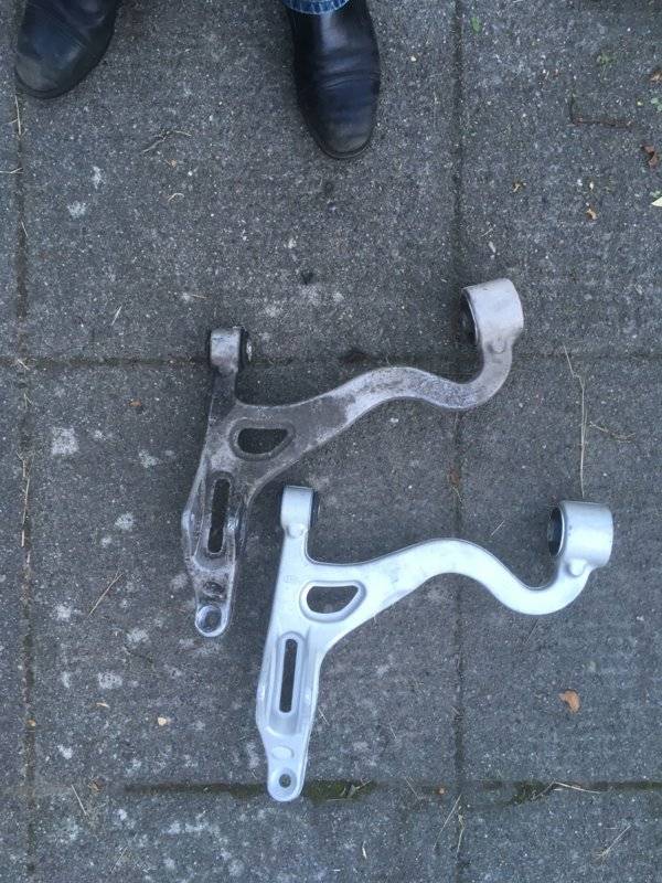

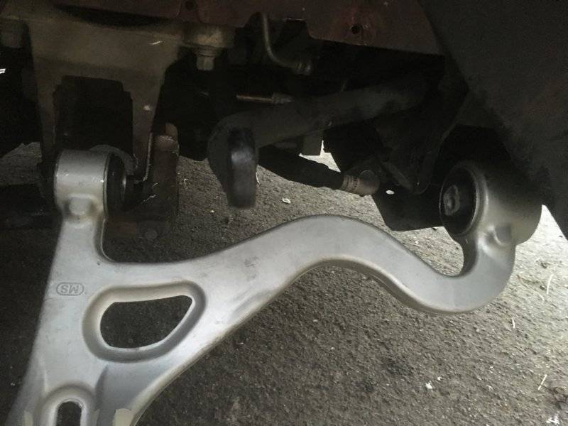

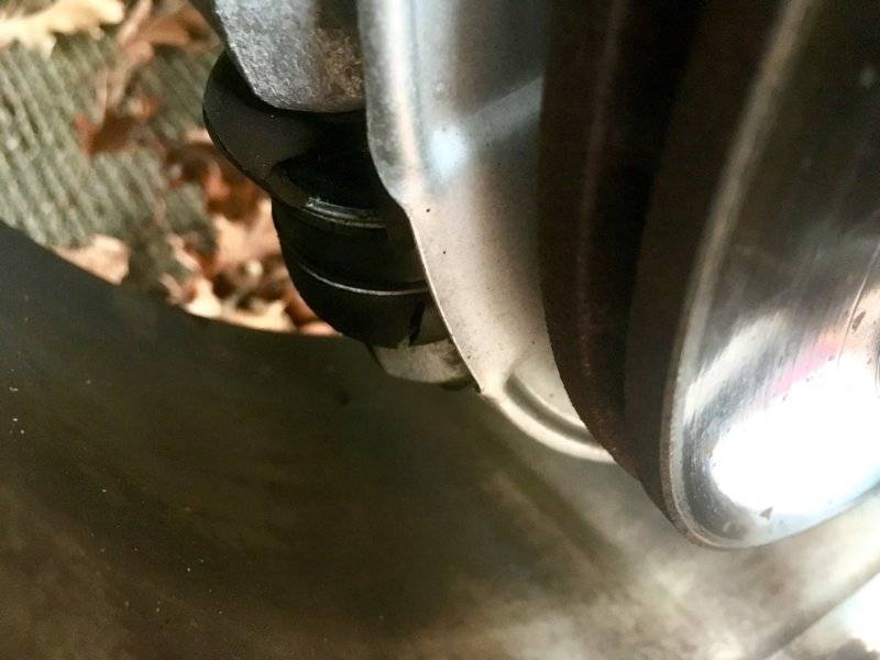

Ok guys, I’ve finally gotten all the parts and a day free and I started working this morning.
Well, it took far too long to disassemble, and the lower control arm was amazingly difficult to get out. It seems like the UCA and knuckle were not in fact bent, and the shock and coil do seem fine. But… but…
The lower control arm was difficult to get out because it was bent, and in fact the thing it goes into at the front is bent as well. I’ve got three pictures below, first a comparison of the old and new, then a wide shot and then the back of the lca showing how far back it is from the place where it ought to be. It’s about a half inch.
So now what? Is there anything I can do here? Is this call a specialist time? I tried hammering the front mount and I tried cursing loudly. It does not seem to have budged. Are there any stronger curses I should invoke?

We all knew the lower arm was messed...so what I hear you saying is the lower control arm ball joint towards the front won’t fit into slot?
