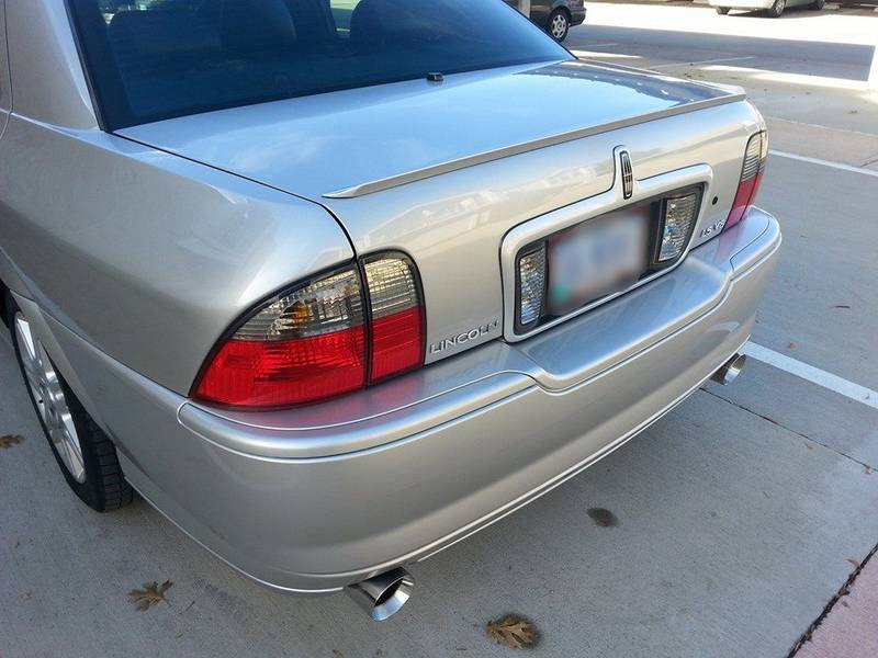

Here's a pic of the old gal :

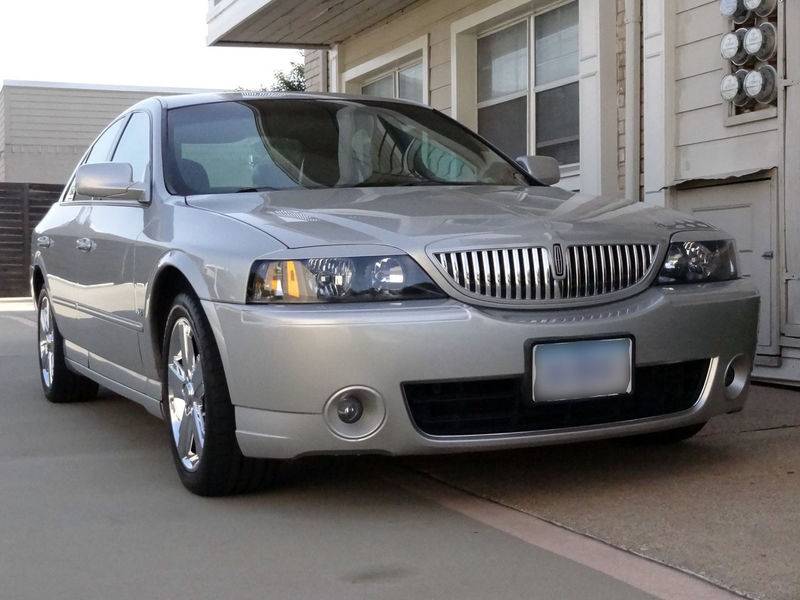

Also, got distracted from the brake job by this :)
Painted by a local bodyshop (~$60), sits nice and flush with the hood.
So sleepy......
