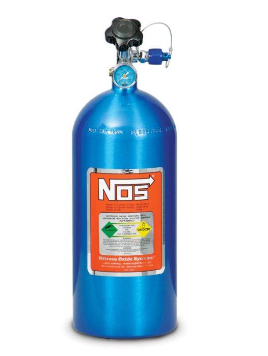

So right now mods to come are a custom cai, ive made three this will be the fourth so no worries there, put on some magnaflows. Next question anyone make midpipes? h-x pipe? and I love nitrous but can these cars handle it? If anything i want my car to last as long as possible, not give it a shorter life lmao.
^^ yeah nitrous in a stock and you might as well stick the needle in its arm, well atleast any shot that would make it worth it, i mean a 25 shot would probably be okay but thats hardly worth 500 bucks
actually i've seen a few sprayed 6ers over the years, a stock motor shouldn't have any problems with a 75 shot as long as its tuned properly, i thought i remember somebody that was spraying 150 all the time on a stock motor, but i may be wrong on that.
Yeah, it's all in the tune!!
I've had nitrous on my mustang for 7 years now (100 shot) with no problems at all. Tuning basics are 2 degrees initial retard for every 50 hp increase, one range colder plugs and of course the best fuel you can buy at the pump. Install a 255 lph pump at least and make sure the engine is sound.
If you miss these basics it'll can turn you engine into scrap faster then you can left off the pedal, my brother learned this the hard way on a $4K short block that had only about 1500 miles on it. Melted an Arias forged piston and scored the cylinder wall bad!
If set up right it can be a lot of fun and safe.

The timing isn't manually adjustable in the LS. It's computer controlled so you would need a special calibration.
