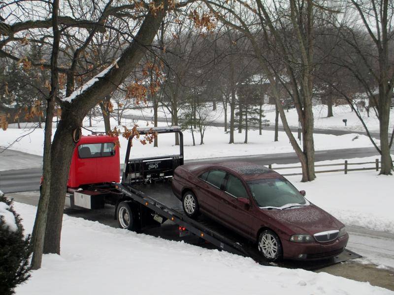

The End
Born: April 25, 2003
Laid to Rest: March 3, 2015
Mileage: 128,435
Final resting place: Stan's Salvage Yard
The LS left me stranded by the side of the road for the last time. Death was premature due to the need for replacement of coils/plugs for the fourth time (replaced three times under warranty) , PCM for the second time (once under warranty) and all coolant hoses/fittings. Other failures common to this car are too numerous to mention and too time consuming to fix. With the reliability issues this make/model is known for, it just doesn't make sense to put $2,500 into a car with a wholesale value of $1,500....only to have it break down again.
