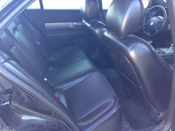

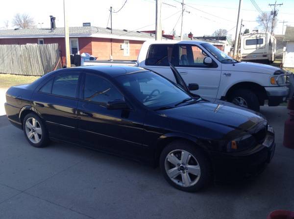

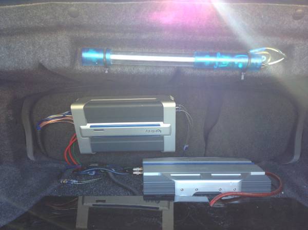

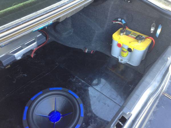

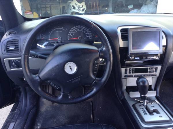

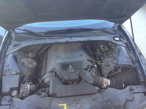

I haven't experienced a 2nd Gen LS but the cars are out there you just have to look and be patient ...here is a 06' about 20 miles away from me.... And this is a V8 with two sets of wheels coming with it 2 inch and factory two battery's with full system $4500 and you drive it home

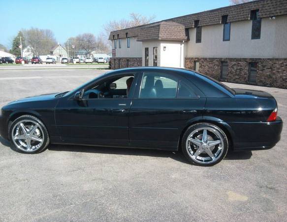

Thanks and ya that’s not a bad deal there. Gonna try and be patient but I also need my car for work so I need to pull the trigger on something or get this one to the shop. I did find a super clean 03 close to me. V8. Interior is flawless looks like whoever drove barley wore the seat in. Does have 130 on the od tho but they are only asking 3900 and I’m thinking they’d take 35 cash. Has records of tune ups and oil changes. Well taken care of. Runs good I checked it out this morning and was impressed how clean it was and ran strong. Does the 03 having any time bomb things to worry about like the timing chain tensioners or tranny issues. I did those tensioners on my 2000 and would prefer not to again haha.
