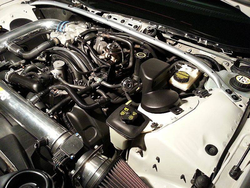

Lol yup. And i cant believe they tell you those plastic push retainers for the cowl are reusable..maybe for the first time. I need to stock up on those. Ended up having to wrap the threads of every single one with electrical tape so theyd hold in place. Also one question for anyone..the strut tower support bar that spans the engine bay, what is its purpose? Does it really privide support, structurally, for the car? Because out of the 7 bolts that tighten it down, 4 had been previously rusted bad and the heads broken off leaving the threads in place. Thinking about drilling them out and replacing if anyone thinks its worth it. Thanks, Nate.
Yes, the shock tower brace is important. It ties the front together and helps stiffen the chassis. Do you think the engineers would design in and spend the money on something that didn't have a purpose? Ever drive a convertible or a car without the brace? Many aftermarket companies make them for many cars. Some cars even have a shock tower brace available for the rear.

and if you don't think that brace is important, just look at one of the very first things people who track their cars put on.... strut/shock tower braces!

I thought the brace was pretty important just by looking at it. I just didnt know for sure. It really pisses me off how the previous owner didnt seem to care about something like that
^ Someone's been in to replace the degas bottle possibly ... it requires removal or at least loosening of that brace.
I color matched mine when I had it out during my cooling system overhaul.
I have access to a tool that i can hopefully extract those broken bolts out with. Wish i would of known about this earlier..i would have had it fixed early on and not ever drove aggressively until it was fixed. Do you think i should get the bolts from the dealer? Or should any bolt of the same specs do the trick?

Any bolt of the same spec or stronger will work. You can likely get the metric equivalent of Grade 8s (has a name, escapes me at the moment) at the local hardware store for about a buck each, possibly less. The same bolts from the dealer may cost a buck each, may cost as much as 20 bucks each. Dealers are usually VERY proud of their bolts.

What he said. Don't forget to match the thread pitch.
So i brought one of the bolts from that support brace to a dealer today. First, he couldnt even find the part listed, even asked if it was aftermarket. Im like..."uhh i think those are on every LS.." After no luck looking up the part with my VIN, i handed him the bolt for measurement and he supplied me with the exact specs. Went to a hardware store and was able to get all new matching bolts, except one minor detail. They were out of the "25" length, so i had to go to "30", which is just a bit longer. Havent looked into it yet, though im assuming itll work just fine. One other thing, i wasnt able to find the correct hardened steel washers, so i bought some regular ones of the same size. Just wondering what anyones opinion on this is, if i should go ahead and use the washers i bought, or look around some more until i find the correct hardened steel washers..i was told as long as the bolt is correct, i shouldnt have any issues. Also, does anyone know the torque specs for these? Believe its 20ft/lbs.
