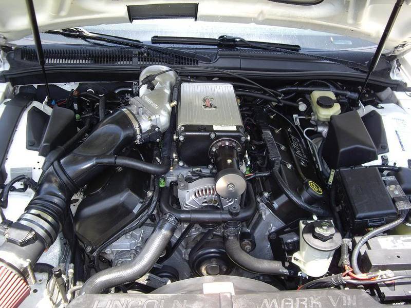

Vortech 7 PSI supercharger. 90 mm MFS. 255 GPH fuel pump. Screamin Demon coils with Live wires. Kooks headers into 2 1/2 inch dual exhaust through a Magnaflow X-pipe resonator. 3800 stall with lock up. 1997 Mark transmission with Dirty Dog valve body. Transmission cooler and Mercon V. 4:10 gears with traction lock. 17 by 9 inch Lincolnmotorsport Cobra style wheels with 255-50-17 BFG comp in the rear and 245-50-17 in the front. Future Drag radials, A/C, Battery to trunk, Weight reduction. Very detailed clean up.

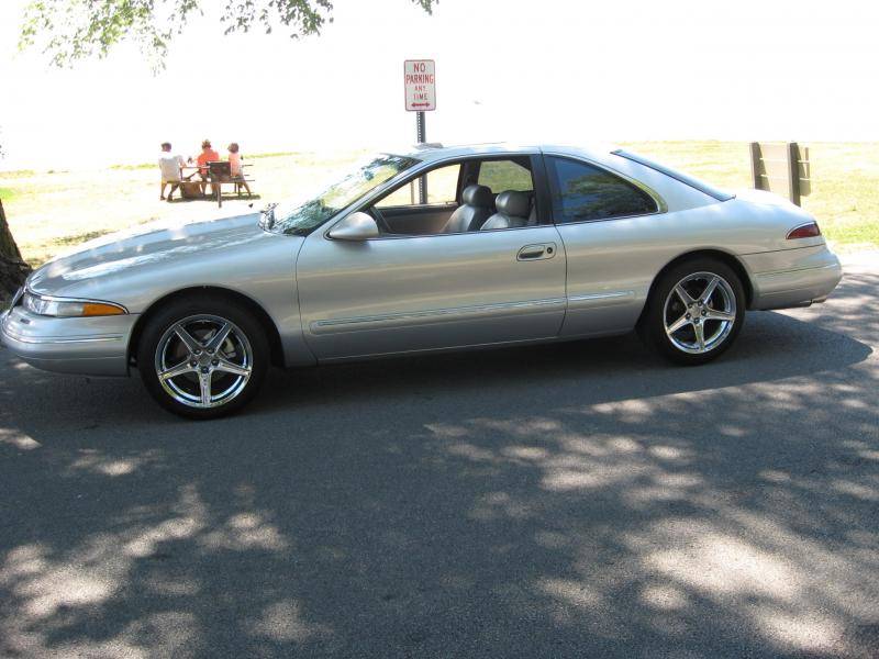

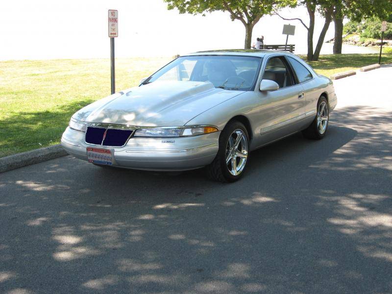

The Mark
1998 Lincoln Mark VIII LSC. 5.0 Forged DOHC Stroker Teksid Aluminum Block. B Heads with 96-98 Mustang Cobra Cams. Vortech T-Trim Centrifugal Supercharger with 3.33 pulley. 17psi @ 7150 rpm. Custom Air to Air Intercooler with two blow-off valves. Current Street Configuration: 492rwhp 421rwtq.
http://www.streetfire.net/video/the-mark-all-done_210647.htm
http://www.streetfire.net/video/sshs8-the-mark-1175112080_197859.htm
Major Mods/Repairs/Parts done to The Mark:
136-2261002 Baer Eradispeed Extreme Plus 2 piece Front Brake Rotors for 1999-2004 Mustang Cobra

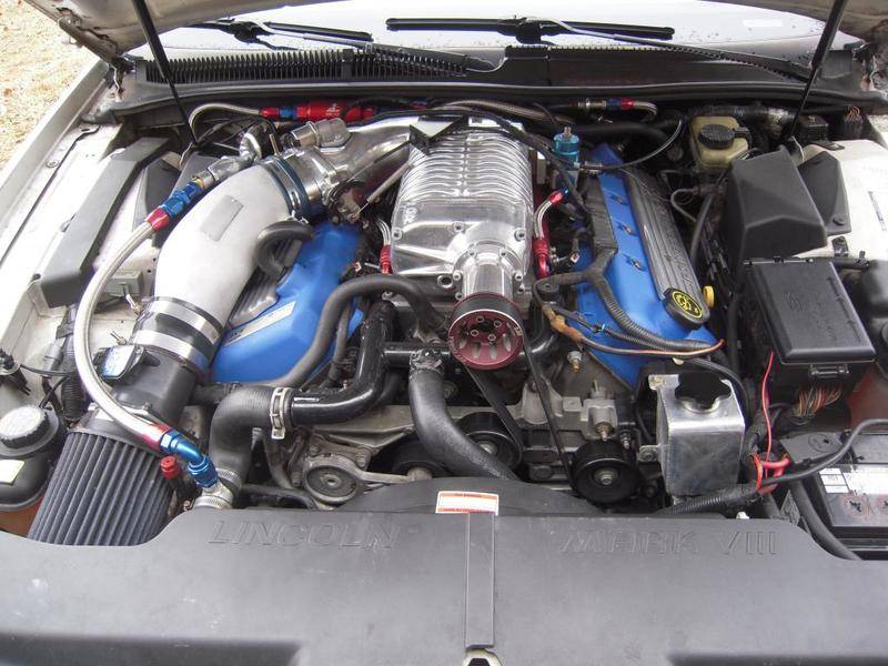

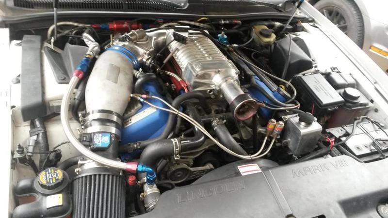

Just another 1996 Mark Vlll with a KB 2.2L Inter Cooled set up on Forged Internals, with "C" heads. Complete front and rear sub frame ties, with poly upgrades. 3:73 Gears with Eaton posi unit. Kooks headers with 3" collectors and full 3" SS exhaust thru Magna Flow Race Mufflers and dual 3" in and out resonator. Focus Fuel pump, Aeromotive Fuel rails and regulator. 60 lb injectors. Fully built trans with Marauder TC. Running on 18" Cobra Stars and BFG's.

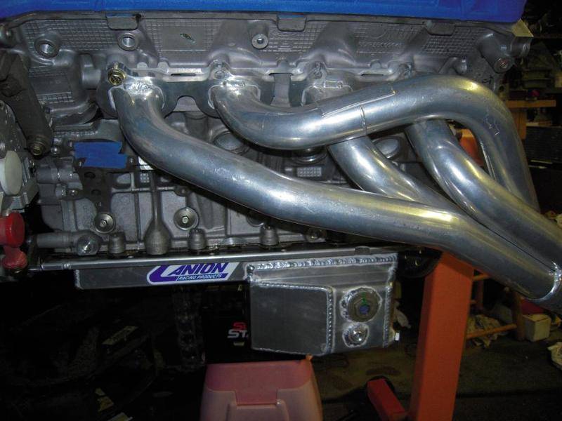

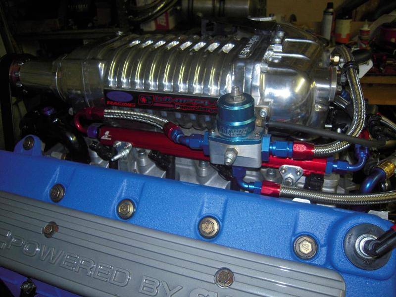

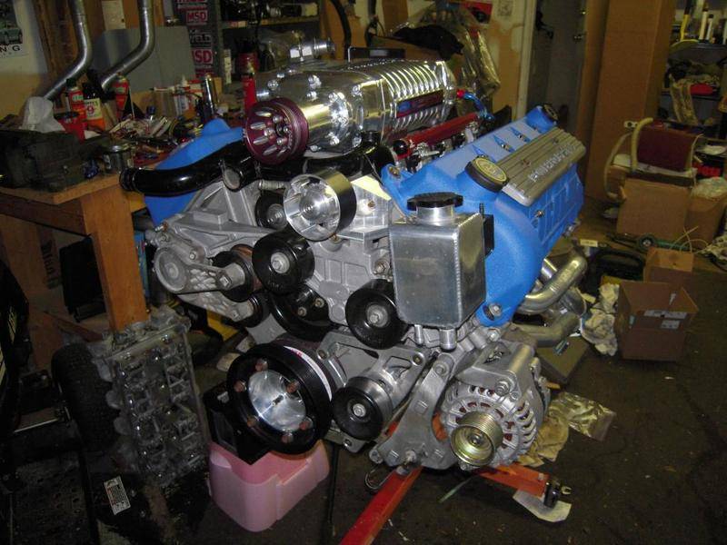

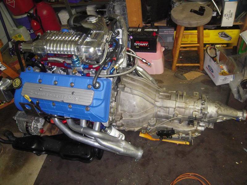

ARP main studs, H beam rods, balanced forged bottom end.

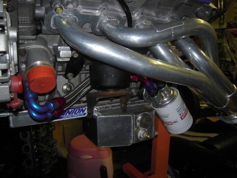

remote filter/braided lines, ceramic coated headers &
7quart Canton aluminum drag race pan.
Kooks headers, TEKSID block, 2001 Cobra ported heads,
SFI 8 bolt flywheel
Gauges inside and the "cruise OFF" button was used as the nitrous button

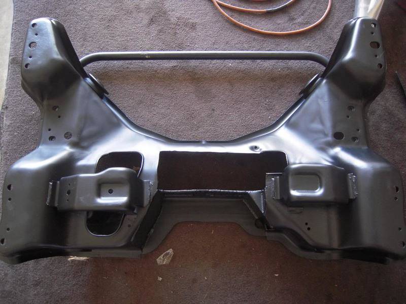

notched/braced cut out for Canton pan
thanks to Doug DLF @ LOD for the instructions with the conversion and steering components.
Paxton regulator/braided lines
60lb Siemens/Deka injectors, GT500 coil covers, Accel coils, iridium X plugs
2.5 mandrel exhaust
3.73 carbon fiber clutch pac rear,urethane bushed diff.
Temple Performance bumper
2010 GT500 heat exchanger/I.C. pump
19" wheels and I don't remember who made them. He put them on another Mustang he bought. He did have chrome Speedstars on it before these. He gave me the Cobrastars and LSC moldings for free. Since we had the same color car, they matched mine perfectly on the 95.
THE END!!
