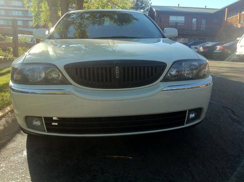

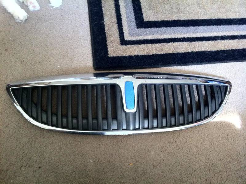

Regular stock gen II Grille
4 layers of 75% opacity(nice and light) on both lower grille and surround

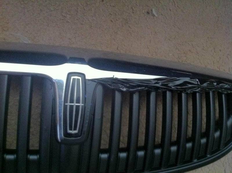

Peeling my first try off the surround... make sure to use multiple light steady coats. Don't get impatient and try to spot spray. Learned the hard way, plastidip comes off yes... but you need small fingers to get all the nooks.
For solid lines: Take the tape off while the final layer is still wet. This technique worked wonders for me but there is a spot where the line isn't as clean because the dip had dried.
Plasti-dip comes off very easily when applied in heavy wet coats.

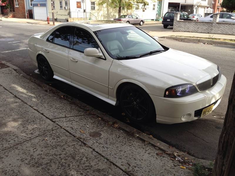

Has anyone plasti dipped this style LS rim? I'm thinking about doing mine but I'm not sure if it'll look good.. I'm also thinking about doing my upper and lower grille, rather than buying the chrome one.

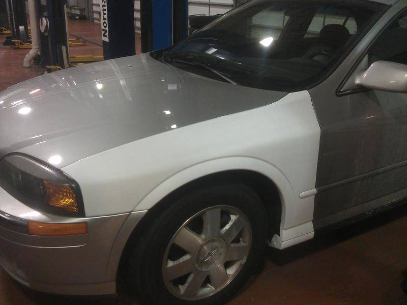

Messing around with dip today...

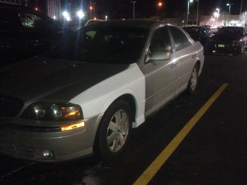

Turns out when you do silver metalizer over white dip you get a nice sparkly pearl color. I think if i had done a couple more coats of metalizer it could have matched a bit better:
I know the car is filthy, its been cold here for the past few weeks...and by no means do i plan on riding with the skirt like that. Dont need any lip :cool:
I will eventually have it painted. I was just messing around today, had some free time.
