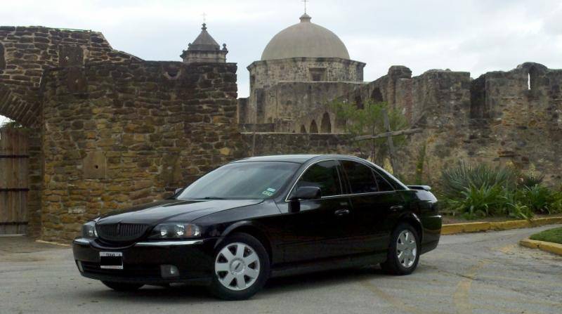

yeah i have the 7 spoke here is a pic of them now i will put pictures once i finish
I will be doing my rims soon im thinking if I should do them black or battleship gray? any sugestions
