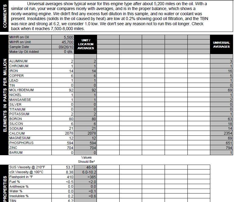

Back to the original topic, I ran this oil for 5500 miles and pulled a sample from the drain valve I have installed. It was Mobil 1 0W-20 run with a Motorcraft filter. Most of my driving is highway driving just cruising 70-90mph for hours. The results look really good.
