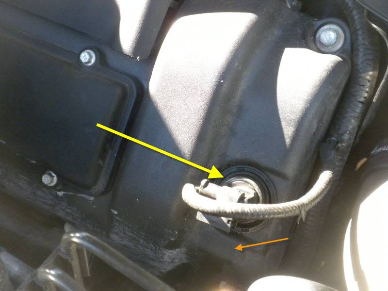

Hey guys,
Has anybody had the oil leaking from the cam sensors? I think that what they are. Its the plug on top of the valve cover at the front of the engine close to the fan. There are two of them (one of each side). The tech advisor at the dealership said that they were cam sensors but he didnt sound too confident.
If so, have you had these leak oil and what is the remedy?
Thanks for the input?
Yes, I've had a leak there.
It's an o-ring that needs to be replaced. You'd be wise to replace the valve cover gaskets while you're at it. The cover has to come off to replace the o-ring.
They're not sensors, they're solenoid valves for the VCT (variable cam timing) control. (To be fair, some service manuals do call them sensors. However, they don't sense anything, but they do control something.)

Do I order the O-rings separate from the valve cover gasket o-rings?

mine is doing this on the drivers side. just a little bit of oil coming out. so my question do i take the valve covers off or can i just seal with rtv without taking valve covers off?
You can try that, but I doubt it will work.
You might try this instead.
http://www.amazon.com/gp/product/B0000AXYZG/ref=oh_details_o00_s00_i00
I haven't tried it on anything yet, but some people with BMWs swear that it cures oil pan gasket leaks just by painting it around the edges of the oil pan after cleaning off the oil using brake cleaner. It's cheap, so I figure what do I have to loose compared to the extreme grief of getting the oil pan off of it. (Getting the oil pan off a V8 LS is very easy.)
Anyway, I suspect that you would be better off to replace the valve cover gaskets and the VCT o-rings. It's not an impossible job.

Not critical at all. It just makes a little mess.
Mine sprays a little.. I am guessing under WOT.

They are not sensors, they don't sense anything. (Some parts catalogs do call them that.)
They hydraulic solenoid valves. They control valve timing.
(Note, there are two camshaft position sensors, one for each bank. However, these are not the things that come out the top of the valve covers at the front and leak.)

Variable Camshaft Timing control solenoids (VCT) - there are two of these. I haven't heard of any failing. The leak comes from an o-ring between them and the valve covers. Just replace the 0-rings if you have a leak.
is there like a part # of these o-rings? I'm going to be doing VCGs soon and these leak a bit on mine. Wanted to get them done while I was at it.
