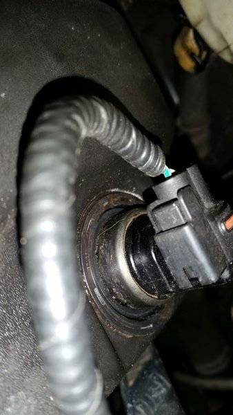

We recently replaced the secondary timing chain tensioners but our kit did not come with this seal for the VCT solenoid.
Now it is leaking on passenger side.
Does the valve cover need to come off to replace or can I get away with it without removing the valve cover?

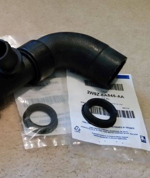

VC's do not need to come off in order to change out the VCT seals, just disconnect the connectors, no need to remove the solenoids either. Use an angled pick and pry the old seal straight up. Take note of its orientation, there is a flange on the top side IIRC, press the new seal straight down. Helps if you have a short piece of pipe same diameter. Use a rubber mallet to tap it down evenly. Reconnect the connector. Keep an eye on it for next few days, check for any further oil sweating around seal. Make sure it's seated all the way to the bottom, should appear flush.
Qty x2
2W9Z-6A545-AA - TascaParts.com (on sale right now)
~ sorry, no pics of in progress nor completed.
Thanks for the help man! The part# on the bag in your pic matches with the part# I ordered off Amazon. Thanks!
