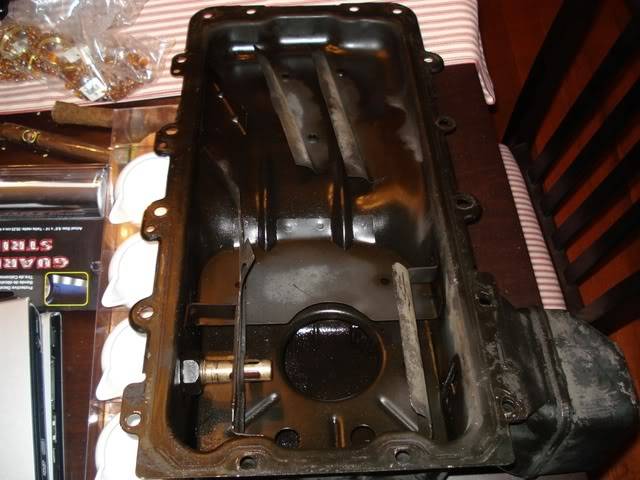

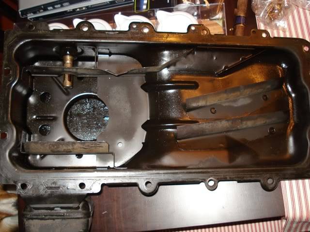

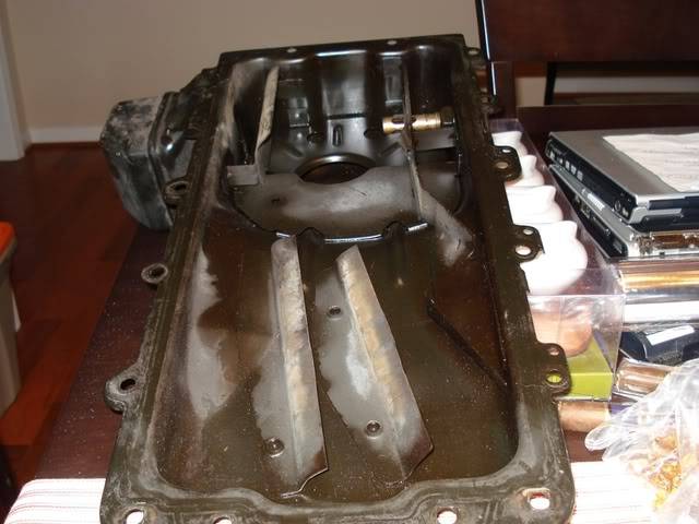

Not a proper windage tray, no. It does have some kinda' welded in, part-windage tray doohickey with some other welded angles for oil control... And a separate reservoir on the side. I'll take a pic tomorrow and post it here.

Edit: Here we go:
haha i'd have to say i think we'd all benefit from a real windage tray. baffling in there looks like something from a last minute highschool project. something i'm gonna have to look into

I've never compared the Mark VIII and 96-98 Cobra pans side by side, but I know they are different.
I don't think there is gonna be room for that tray to be sandwiched between our blocks and pans.
Our pan is very shallow at the front end (approx 1.5'' deep) and has all those baffles, some of which actually sit proud of the pan. I think, at the very least, they'd need to be removed, which may have a bad effect. Also, (I haven't looked into this) but, there may also be pick up tube differences which may pose a clearance problem.
