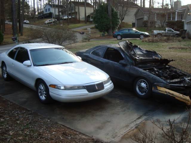

My third cat was stopped up but before I found out what the real problem was lol, I done this to it.
What did it look like before this?
All I can suggest is to leave the fuel injectors alone. Have your cats checked.
i have read up on your experence and will never do any fuel system work in a garage ever agian. every time i see your car it reminds me to take my time. and i cry a little inside. i recently lost an e30 vert to a small fire. i am sorry for your loss it sucks bad. but thank god you are agile and you kids weren't anywere near. how is your leg? didn't it get burned?

I only had a burn spot on the top of my foot / ankle that was the size of a dime and the other leg was cut. It needed about 3 stitches but I kept it together until it healed back. Other than that, no injuries. My 7 year old son was on the opposite end of the house and my dad was just on the other side of the wall from the garage. Everyone came out fine. I would do the job again but next time, I know to not just shut the hood and think I have it done right. That's where I messed up. I didn't check for leaks but doing what I done was useless anyway and stupid.
