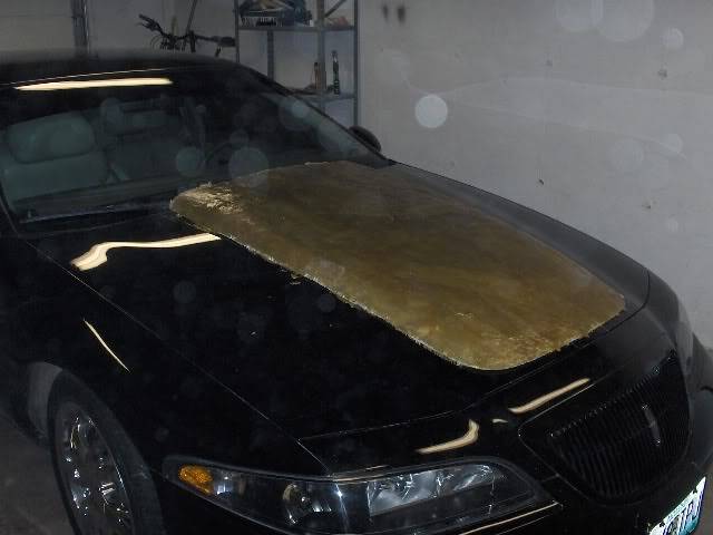

he had pics of the entire process on the hood, someone misunderstood him too, he said he didnt want to make it again lol, he said after all the time invested he wouldnt bother again. he used foam strips layed out on the hood and put them on one by one until he had the width he wanted and started glassing it. the car has a wing on the rear too that he hand made and welded on. wheels are 19-20 combo and serious work was done to make them fit, including hoggin out the rear IRS camber bolts so he could get the giant tires to sit flat. his name is LEE. the car isnt a LSC either, it started life as a 97 Base.

I pm'd him a while ago. He gave me some details on how to do both. I would love to get both of them made...if only I had the cash...or skill.

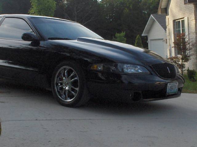

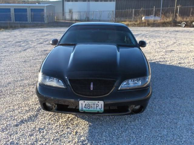

the straight front and sides of that hood dont look
good on a second gen
the photo angles hide the problem

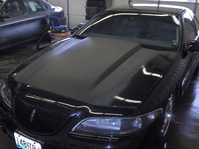

this one shows the flat non body line matching front edge, it looks like crap
this shot shows how the sides of the scoop just simply dont follow nor accentuate the stock body lines.
again looks hideous
I give him an A for effort and and F for implementation.
the mark 8's styling doesnt needs to be IGNORED it should be embraced, not replaced.
i agree, i respect his effort and it came out nice but i think the 2nd gen hood looks good stock, 1st gens is a different story a cowl looks killer on them if its the right hood, but the 2nd gen is better left alone in my opinion.

On the front of this one, he should have come up more gradual from the nose, and cheated it, or worked on the nose so the valley wasn't there between the hood and nose.

Do you see how the factory hood line runs from edge of grille towards the mirrors? You wouldn't have to follow that necessarily, but if you at least acknowledged it and used it as the influence on the scoop it would look alot better.
Side profile.. it looks way too low in back, also. But really it isn't. He just brought it up too soon in the front. And also, since he did that, there is a dip between the nose and edge of hood. He should've taken the nose line into account also, and worked with it, instead of just forgetting about it thinking it would be ok.

ive repaired the front of the bumper 4 times since i made it.all 4 times though my wife was driving the car.as for the hood there was plenty of options i could of followed,i went with what i liked,if i was to do it again?i would make it alittle differant,wider in the back,more of a slope in the front,and more of an angle at the rear of the cowl,i should of followed the angle of the windshield.but i will be doing more to the car soon,right now we just moved to Orlando and dont have a garage to work out of yet.
