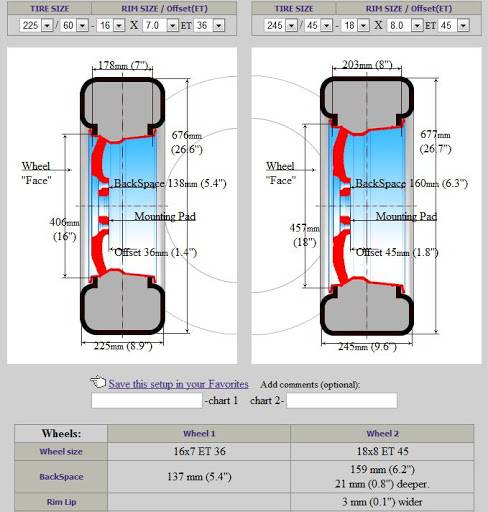

i know how this works thanks.
18x8 with 45 mm offset has a front spacing of 1.8 inches.
a stock wheel, 16x7 with a 36 mm offset has 1.6 inches of front space.
.1 inches difference in front spacing! the wheels will sit no farther in than a stock set of wheels!!!!!!!!!
THEY HAVE THE SAME FRONT SPACING!!!!!
actually a little more than stock wheels.

So, the wheel I have chosen is going to require a spacer of some sort because the wheel only comes in 18X8.0 with a 40mm offset. I would also have to get extended length lug nuts and none of this is no big deal, if it's safe and doesn't have any effect with the balancing. I'm assuming I'll need a set of 1/2" spacers in order for this wheel to fit right? The hub bore is 73.1 btw.
sigh...
Wait, it looks like it's changing again. 45MM is the best I can do.

What math are you using to get 1.8 and 1.6 above?
My math gives me 3.08 inches front spacing on a 9-inch wheel with 36mm offset. 2.228 inches front spacing on an 8-inch wheel with 45mm offset.
2.08 inches offset on a 7-inch wheel with 36mm offset.

here. but all of there :q numbers may just be wrong.
