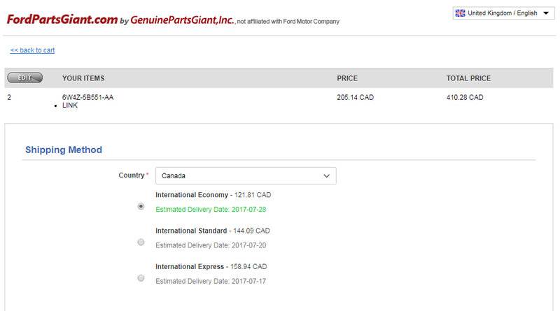

Ford Parts Giant comes to 439.26 CAD Shipped to my door with a delivery time of 2 weeks. They seriously charge $150 to ship to my address (Halifax Nova Scotia)... Any way you cut it it's a shitty deal. Best option is to get them local.

Just got back from being away. I delayed the purchase until I knew what I was going to do with the cars. So just to clarify, they're $210 CAD from the dealer, plus tax so a pair is around $483. Buying from the US is actually more expensive with their INSANE shipping. I called the dealer and spent about 20 minutes trying to explain what it was. He couldn't find anything for Rear Toe Links. I had to call back with the part number.
This is a photo of the checkout. $532 for two OEM toe Links.
