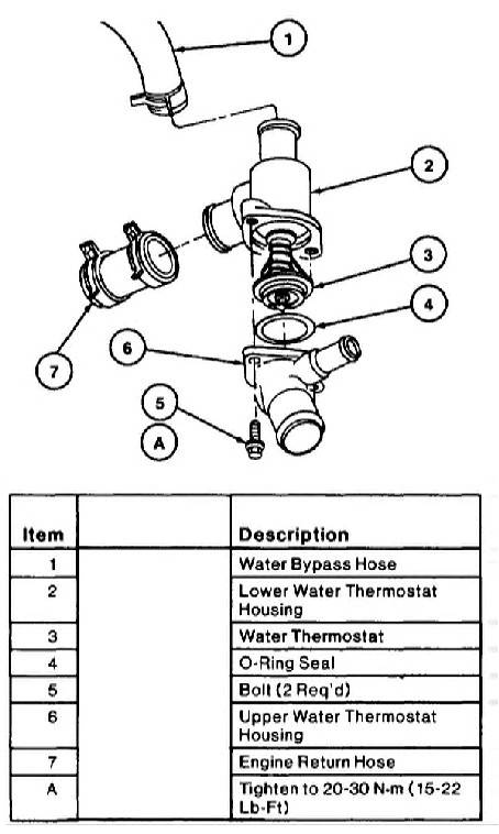

If it's overflowing the reservoir then your thermostat is not working properly. Defective thermostats are pretty common.
thats 2 Duralasts in a row from Auto Zone. screw em,, getting a 180 Motorcraft from O'reilleys

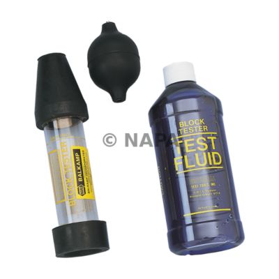

I said it before, your car has a blown head gasket. It overheated with no thermostat. If I were you the next thing to buy would be a hydrocarbons test kit.

Run the hydrocarbon test and put this issue to rest.
