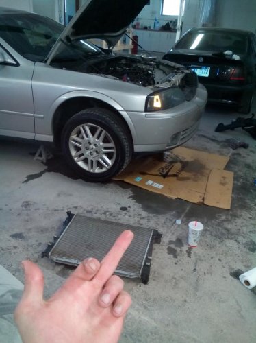

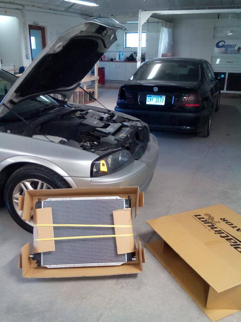

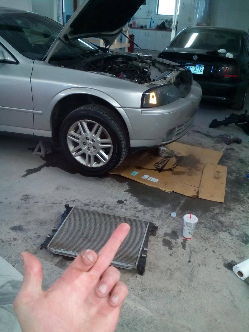

Radiator is waiting for me at the shop. Going to be heading there tomorrow morning to install it as well as remove and seal my cooling plastics.
I'll be tackling this by myself, but I have the entire day/night so I'm just going to take my time. Anyone got any tips for the radiator swap? Preventative damage, or proper process tips? I'm planning to just use the denau manual but any other advice would be great. And I'm going to be removing and installing from the top because I don't believe jackstands will be high enough for me to pull and install from the bottom.
Thanks in advance for the help and tips guys, gotta spend some time with the wife now. God bless
Done with radiator, now just wondering if someone can answer me on this so I can finish up.
I'm going to use tack seal permatex on the rubber ring gaskets for the main plastic cooling body. But I'm debating using blue RTV gasket maker for the plastic body surface that bolts to the engine block front face.
Is there any reason I shouldn't use the blue RTV? Please respond asap so I can finish up. Thanks guys

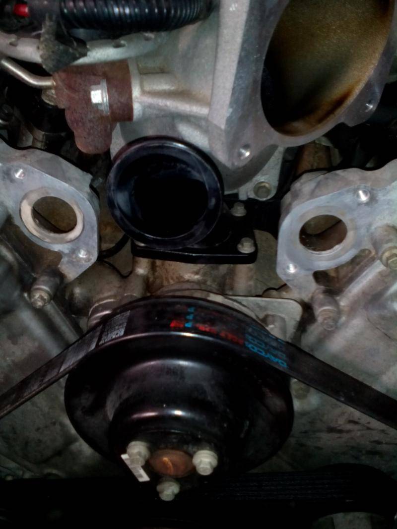

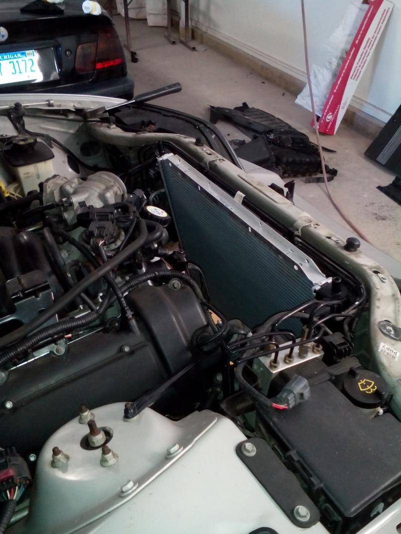

Finished the Radiator install and sealed my main plastic cooling body with Permatex tack and seal as recommended by Joegr. It took me all day to do everything, however despite not having a 5/16th's racheting wrench for the removal it really wasn't that bad. My wife brought me food and took me to go buy the wrench to make the install quicker. Here are some pics for fun.
On the last photo, on the right side of the engine's front fascia where the main plastic body meets, you can see how clean it is compared to the left side. The residue that was built up on the left side was the same on the right side, I cleaned them both before installing the main plastic body with tack seal.
