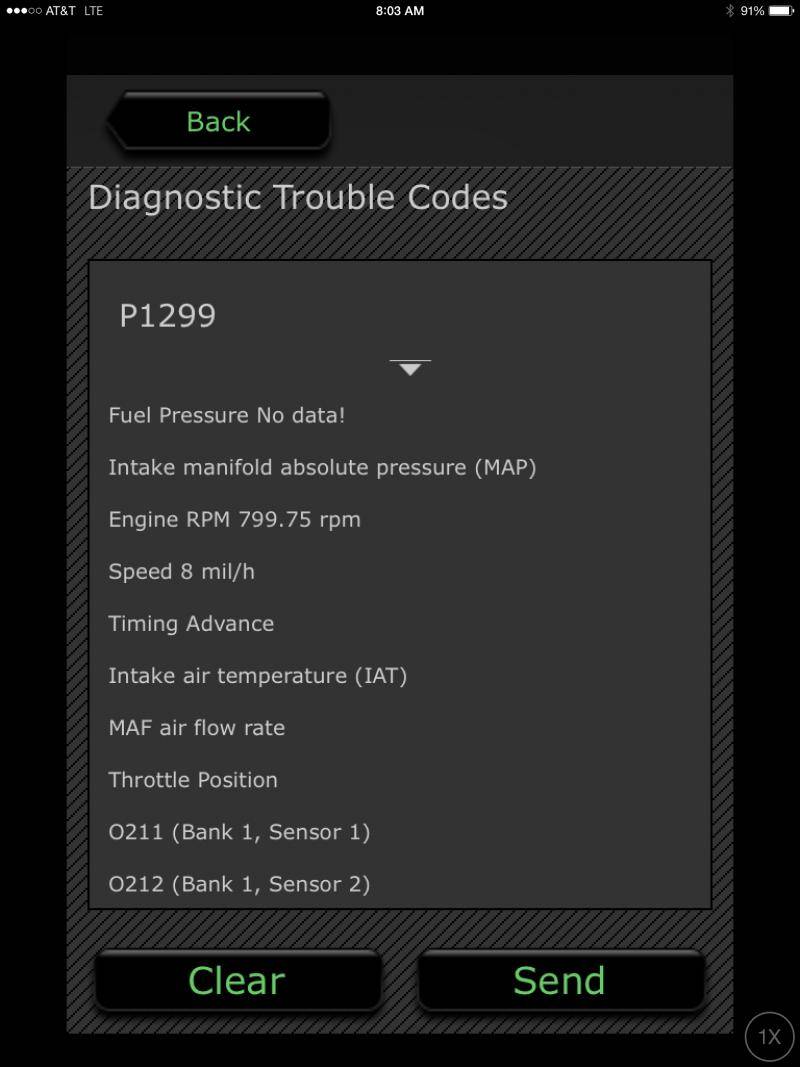

Started over heating last night. Temp gage raced from normal to redline when getting into stop and go traffic. CEL came on with "check engine temp" and "engine performance decline". Pulled over, pulled code P1299. Cleared code.

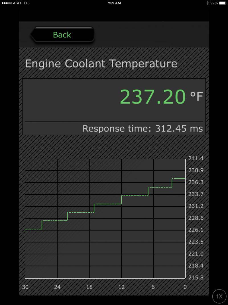

This morning same thing. Crept up to 258 before I could get pulled over. Same everything as above. (In only 1.5 miles) Limped to firestone. (Where all my vehicles go) Coolant was low, they did pressure test and pressure was normal. They said that the coolant was low because it was getting so hot it was coming back out of the degas tank. That didn't make since to me. They diagnosed it as the hydraulic fan motor since the fan wasn't kicking up to high. Fan would run just not kick up. They wouldn't touch it since none of the techs had experience with hydraulic fans. Suggested I take it to the dealer. YAY for me.

Yes, if the fan isn't working your coolant will boil into steam and be expelled out the pressure relief on the degas cap. Would you rather that it just explode?
(Still, the odds are good that your degas bottle and some other plastic parts need to be replaced if they haven't recently been replaced. This is not your problem right now, but it may be next week after you get the fan fixed.)

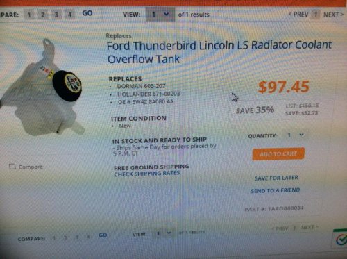

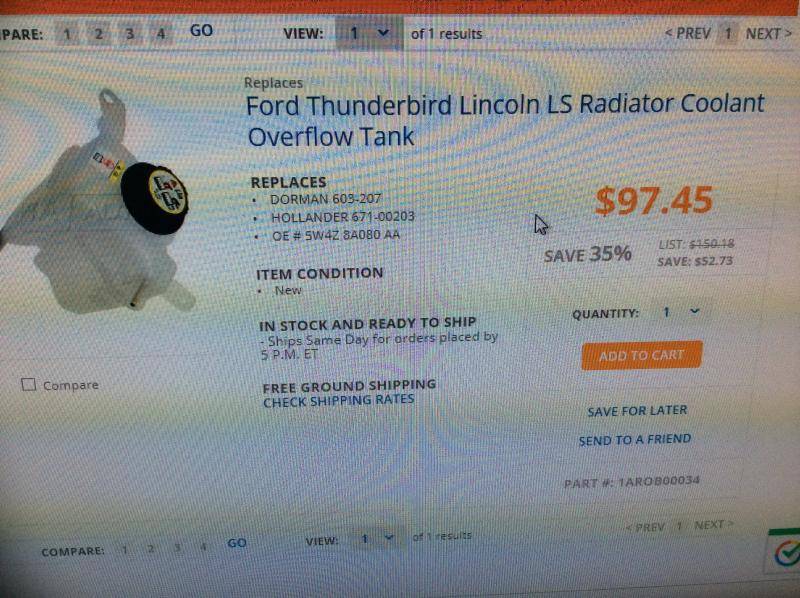

Called to 2 Ford dealerships and the part is running $212 before tax. WTH? all the previous posts I'm seeing them at the dealerships for $150 or less.

I should say it isn't dorman. It is from 1aauto.com.
It says it replaces dorman, Hollander and oem.
I'd bet that it's really the Dorman with a different name stamped on it. Of course, I don't know this for a fact.
The OEM part is around $175, mail order (or $250 retail).
Agree..... I saw one of those also and even though it said replaces Dorman, it was actually an updated Dorman.
