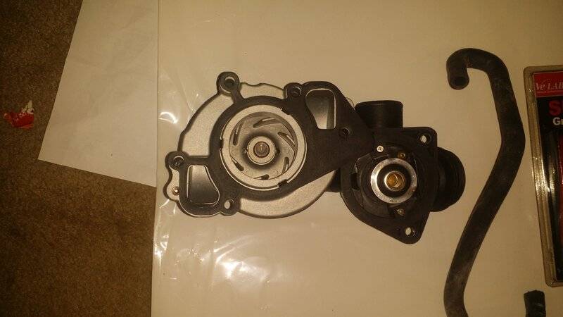

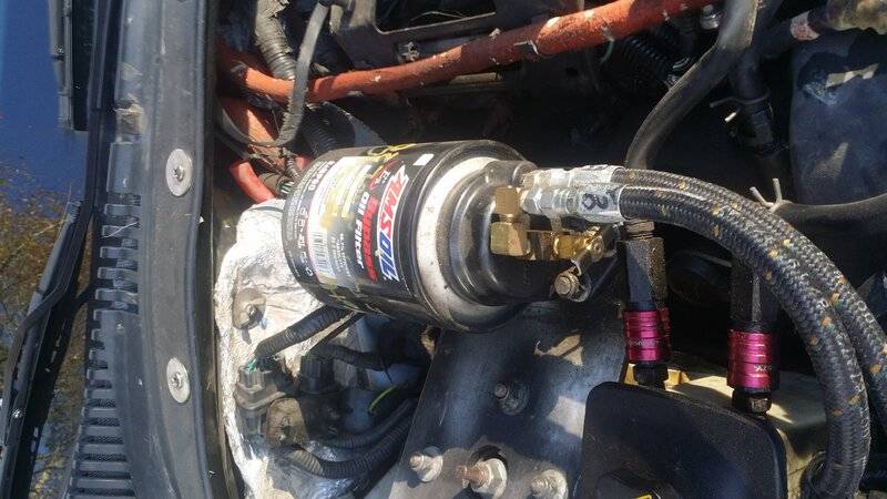

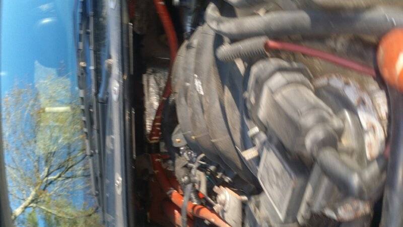

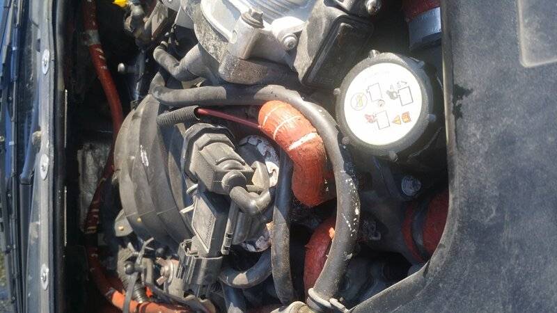

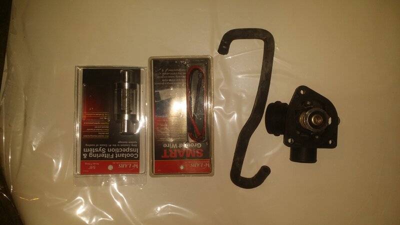

Vee can't be seen unless the intake manifold is removed. I had this hose slowly leak, $$$ coolant wasted solving this one. Another mystery leak was the by pass 1/4 ID hose on the thermostat bridge piping, it would reveal the hose split only during hot sunner freeway driving. $ coolant wasted. If the plastic piping from the radiator begin to split which I replaced multiple times with 1.625" diameter copper tubing. Used copper because of the oil filter heater/cooler lines. I solder in the hose fittings after a drill and tap before the solder applied. Another fail is the thermostat retaining tab breaking. A 4-40 screw with a #43 drill bit size added strength to the tabs. The water pump has a aluminum impeller vs the plastic.
