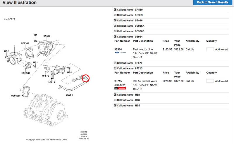

Pretty sure I just need to replace the fuel injector line that runs to the idle air control valve as there is a large crack in the line right at the t fitting. (circled in red below)
Found the factory replacement here for $115. http://www.fordpartsgiant.com/parts/ford-hose-asy_xw4z-9e964-aa.html
My question is does anyone know what size lines and fittings you would need to fabricate a custom line on your own?
Seems like you would be able to do it for under $50 if you just bought the lines and fittings and put them together yourself, I just have no clue what sizes would be needed and where to find the proper fittings.

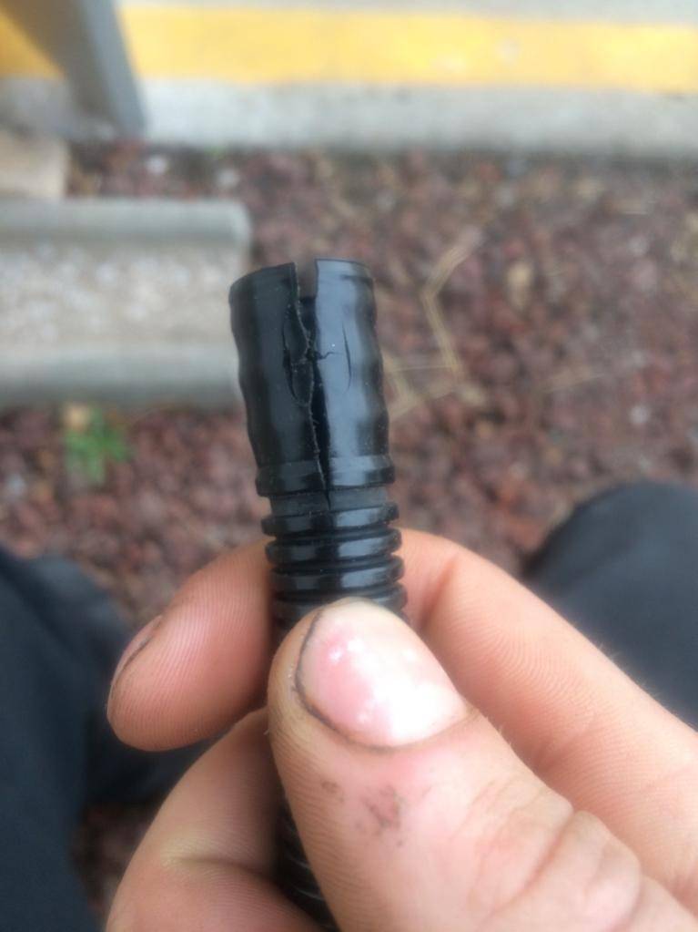

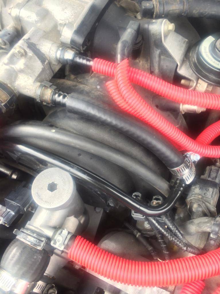

Got a new line put in today. Turns out it was just the line running from the T fitting back to the IAC valve.
Must have damaged it when I pulled the valve for cleaning and installed a new gasket.
Just cut the end of so I could use the fitting for the IAC valve, put some gasket maker on there and rammed it into the new hose. The other end wasn't quite as tight a fit on the T fitting so I used gasket maker and lightly clamped it to be safe.
