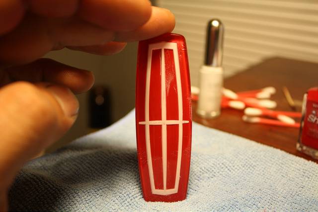

very delicate situation with these embles, I say this because they do show every imperfection once the product is done.The emblems that were used are salvaged emblems from ebay and local salvage yards.

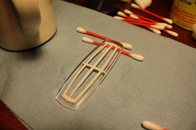

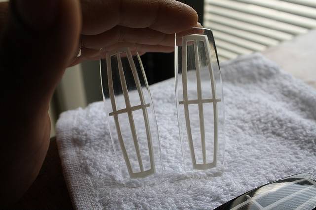

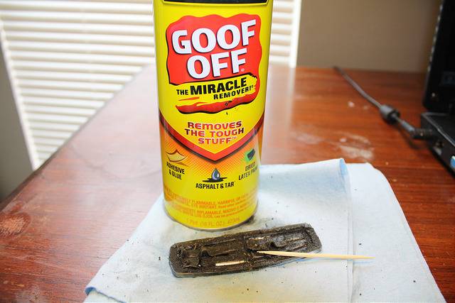

Step 1: I used Goo off for most of the glue and paint, make sure that you do not use to much of this stuff as it WILL CRACK your emblems. I used a tooth pick for the silver stock color on the emblem this is the the hardest part make sure you get every tiny little speck out as it will show later on.
Step 2: I used a microfiber towel with some Goo gone and the emblem very gently.
Step 3: I used my wifes nail polish for paint she has alot of diffrent colors of very fine paint brush, so thats what ive used so far and some acetone for the clean up using q-tips make sure to look for any left over paint very carefully under a light.

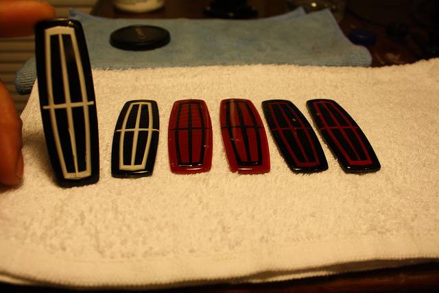

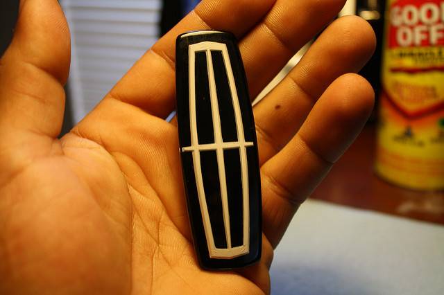

Step 4: let the painted star dry for at least 2 hrs or so and then you can paint the background what ever color you like.I then waited 24 hrs before installing letting the paint dry, I used 3m tape to re-install onto my grill and rear surround.
This set was the best so far with no stress cracks with no pitting at all

if you set the emblems in acitone for about 10 minutesthe paint will come right off. once you pick it up the black and silver will fall right off and all thats left is a clear emblem.
