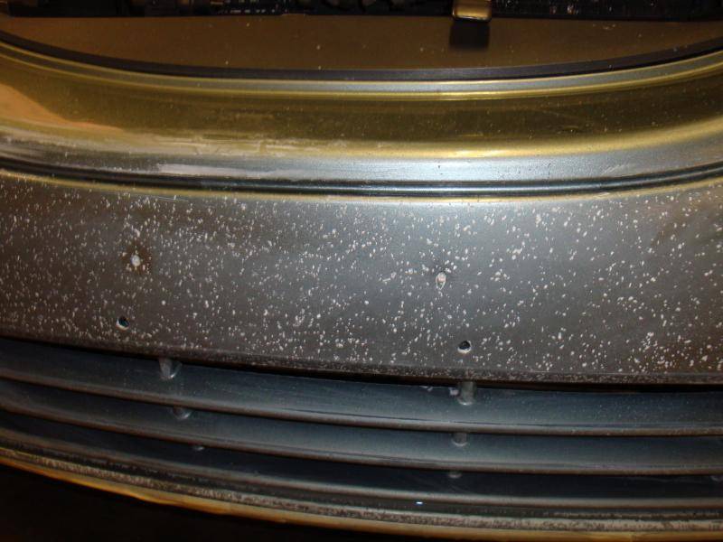

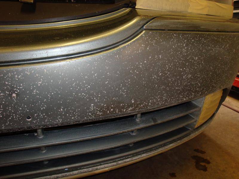

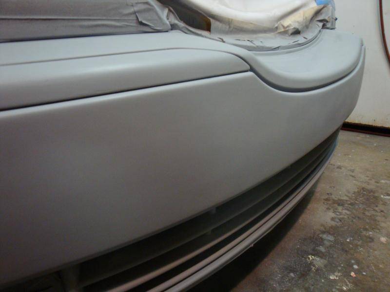

I'm a teacher and school is out for the year so I have some free time and I decided to tackle my front bumper today. It is a complete mess from paint chips (driving to work on the highway) over the last 2 years. I'm trying it myself using some paintscratch stuff. I'm using their flexible primer, got a couple cans of custom match paint and also a couple cans of catalyzed clear coat (extra hard). Obviously I have a long way to go but I am pretty happy with how its turned out thus far...This is where I'm at after about six hours of filling, sanding, priming.

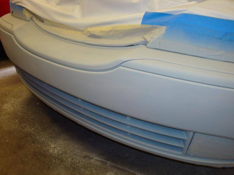

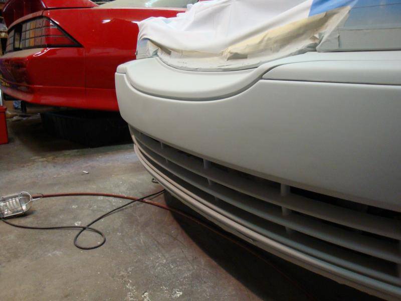

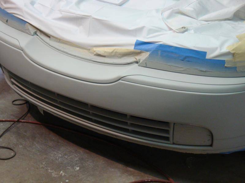

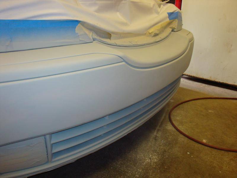

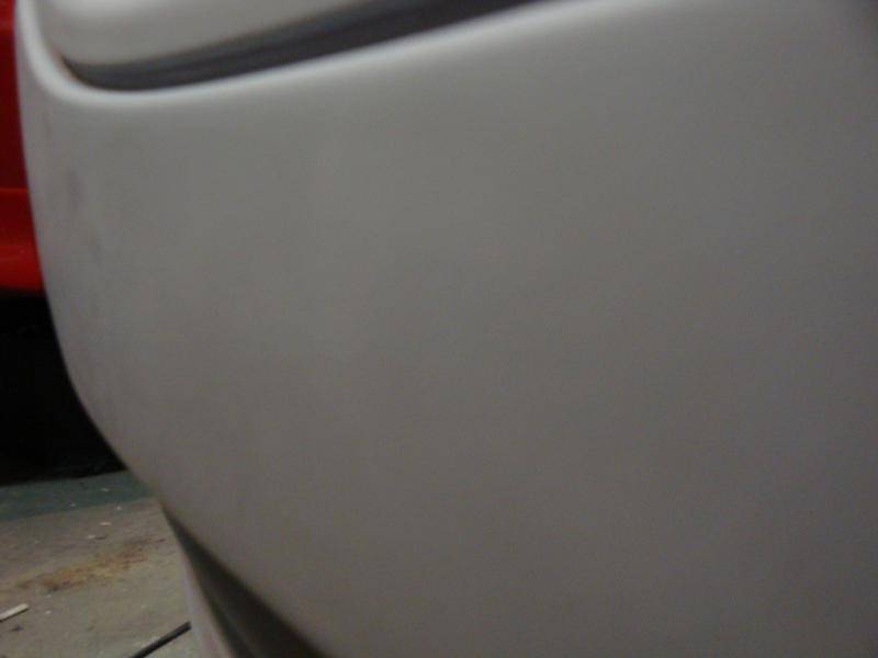

More sanding, filling, priming today. I have worked my way from 300 grit to 2000 grit on my primer and tomorrow morning I will be applying the first coat of actual color. My dad stopped by to check up on me and make sure I wasn't completely destroying my car and he seems to think it'll actually come out pretty good. He has painted steel his whole life (from huge pieces for bridges to roller coasters) and has given me some good tips.
Here are a couple pics earlier in the day. You may notice some areas I missed but I have probably corrected them since.
