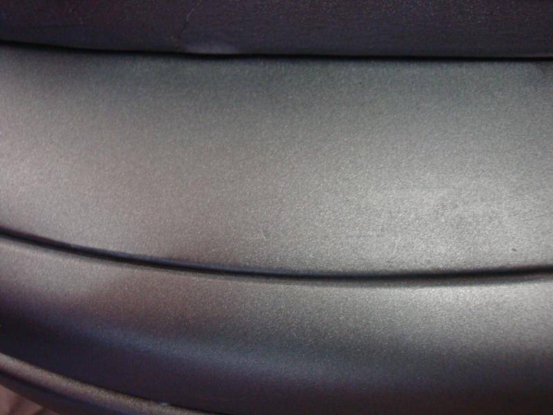

painting my own bumper...progress pics

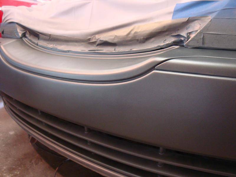

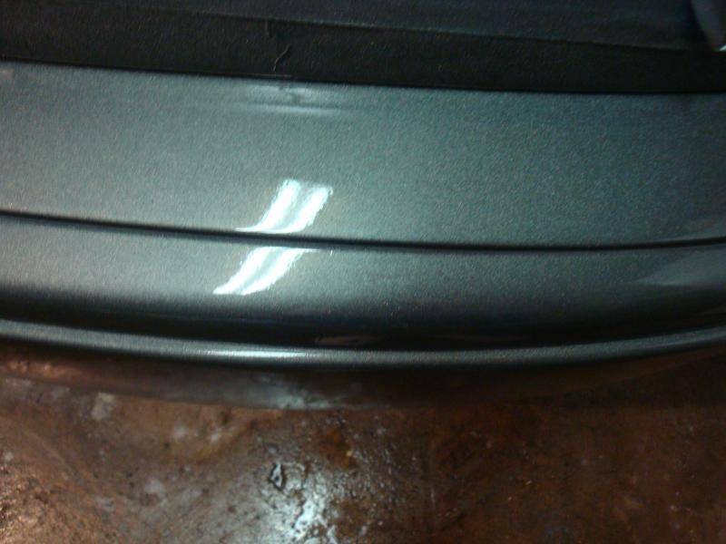

So I sprayed color today. I plan to wet sand with 2000 grit sandpaper, respray, and then put on some clear. I got the catalyzed clear which is supposed to be harder and also shine much more with less polishing...we'll see.
I think the color looks pretty good so far considering it's a metallic....and from a spray can haha.

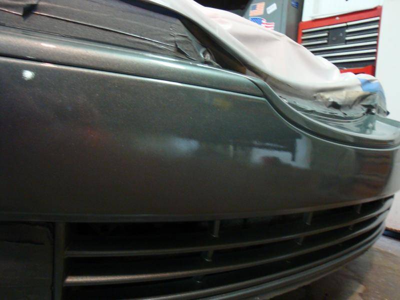

Just about done!!!!!!!

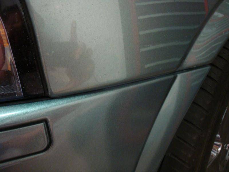

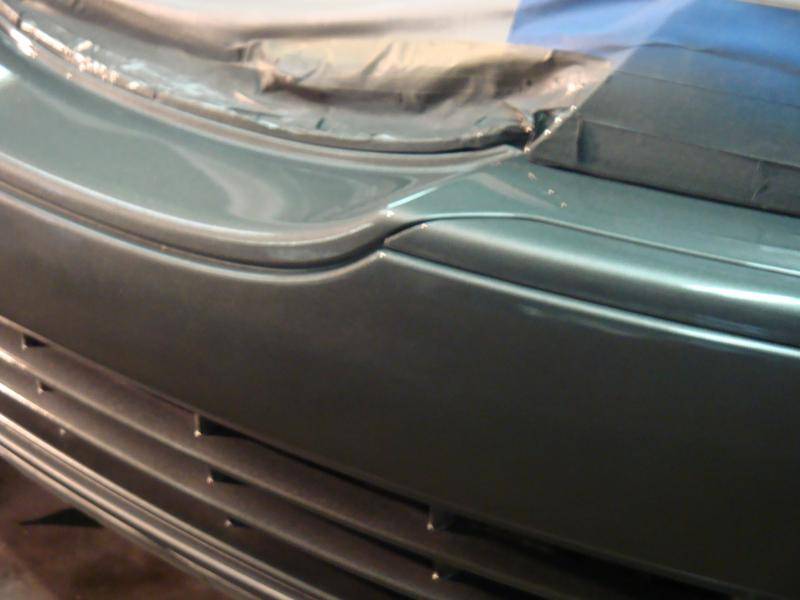

So here it is gentleman. The new bumper seems a bit darker (I assume from sun fading the 7 year old paint on the rest of the car) but the shine is there and I think it looks a crap ton better than it did. Also, the old paint is not clean at this point either and has a lot of dust on it (been in the garage for nearly 4 days).
THIS IS WITHOUT BUFFING/POLISHING OF ANY KIND! THESE PICS WERE TAKEN ABOUT 3 HOURS AFTER THE CLEAR, SO IT IS DRY AT THIS POINT. Could it look better....of course. Could it have come out a lot worse....oh yea. Am I glad I spent 100 and not 1000....yup. A
The before and after pictures look a SH*T load better. The third pictures awesome. You can see what you mean in the last photo. The bumper looks a little "bluish" in comparison. But thats a deal for 100 dollars. Looks good. Fast too.

Here's a fairly detailed write up - if you have more questions I'd be glad to answer.
Sand everything down. Rub with a wax/grease remover. Fill with glazing (bondo). Let dry and sand. Wipe it down again with wax/grease remover and a tack cloth and spray first round of primer. Let dry and then sand everything with around 300 grit.
Noticed a BUNCH of imperfections. Fill again with glazing. Let dry and sand. Use an air hose and compressor to clean it off and also a tack cloth. Round two of primer. Let dry and sand with a slightly higher grit (320). REMEMBER, MY BUMPER WAS A TOTAL NIGHTMARE SO YOU MAY NOT NEED TO DO NEARLY AS MUCH SANDING OR FILLING SO YOU COULD PROBABLY START WITH A MUCH HIGHER GRIT PAPER.
I repeated step 2 at least 5 times. I went through almost 5 cans of primer to build up some imperfections. You need to be patient and get a shop light you can hold in your hand to survey the area very closely to find all the little pin holes. When I was happy with the primer, I wet sanded the whole thing with 1000 grit and it actually started to feel like a car again - very smooth. I aired it off, used some more wax/grease remover, and a tack cloth to clean it. Make sure it is very very very clean - it pays off in the long run.
I sprayed my first layer of color and used nearly an entire can. Since it's metallic, you need to stay far back to make sure the metallic look stays consistent.
After it dried, I wet sanded the color with 2000 grit and once again was very meticulous about cleaning it. I aired and tacked again.
I put on another light mist of color, let dry, and gently wetsanded with 2000 grit again. I aired, tacked, and used one final rub down of wax/grease remover.
Finally I sprayed a light coat (staying at least a foot away from the car) to make sure the metallic flowed well. (I think I could have done this slightly better because there is one spot that looks a bit more green and not as 'metallicy' but it's not that noticeable - i learned something for next time) :)
I let that final coat dry for about 25-30 minutes and sprayed the clear. I DID NOT DO ANY TYPE OF SANDING TO THE FINAL COLOR COAT BEFORE THE CLEAR. I JUST BASICALLY CHECKED IT FOR DIRT AND AIRED IT OFF.
I sprayed the clear and let it dry. I bought catalyzed clear coat from paintscratch instead of the 'regular' clear coat because they claim it is harder (and obviously I need harder to help reduce the amount of rock chips). They also claim it requires less work and should be pretty glossy without polishing. If you use 'regular' clear, you'll probably need a buffer and some rubbing compound (I hear 3m makes some good stuff) to get the shine up.

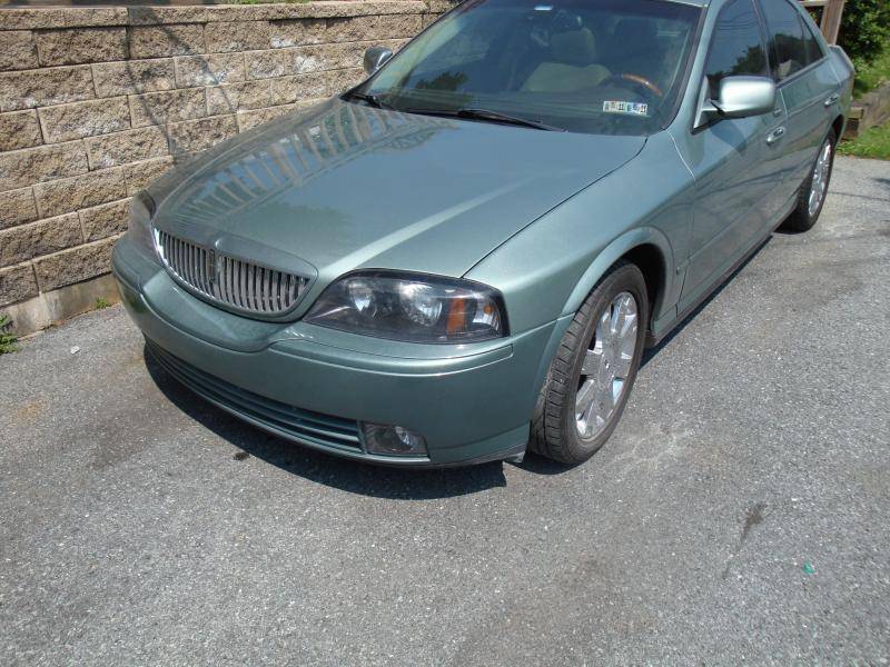

outside pic
The car is filthy at this point but at least it's in the sunlight for a better shot. I'm still kinda hesitant to wash it and get soap and crap on the bumper. I'll probably just deal with it being dirty for a couple days to let the paint cure.
I haven't decided whether I will use a rubbing compound on the bumper or not - it's already pretty shiny.
Next job to tackle is to sand the lights and get them looking good again.
Amazing what can be done with a little time and patience..Nice job and the last pic the paint difference is hardly noticeable!
