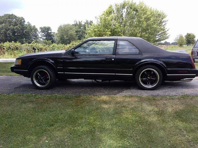

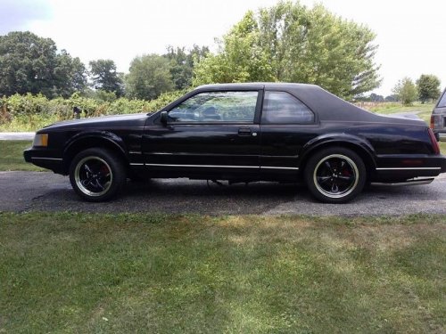

pics of new rims

Are the 17" bullitt wheels the same back spacing for a sn95?Wondering cuz in a few weeks ill be looking for wheels.ALso since you converted to springs you should of gotten a tubular k member.Would of been perfect to drop some weight.
Either way im inlove with your car i recently just got done converting mine to 5spd and man is it fun espicall with 4:10's.Funny when i leave a stop light and people that know these cars fly up to me and look like there lost.lol

ok so I have been looking and searching for the install of these wheels. Im not sure I want to switch to the sn95 spindles so how did you go about getting these to fit on the stock front rotors. Do you grind the inside of the wheel, grind the hub, or spacer it. Thanks in advance.
Having performed the swap on my 7 over to Sn95 hubs , I just cant see why anyone would want to grind on or lathe a set of brake rotors or nice rims.
Too much work and then you'd have to grind again any future brake rotors if they needed ever replacement. If you bored the wheels you'd def want to know they had plenty of meat in the hub area so they wouldnt crack while driving and that the machining was done precisely to prevent vibration.
Yea.. dont think I'd want to set out on a road trip doing 80 on the interstate with all that goin on. Much easier to just swap to Sn95 hubs and use any of the thousands of different wheel choices available for that hub size.
It is simply, not worth the time or effort to do any clearance on the hub or the wheel itself.
